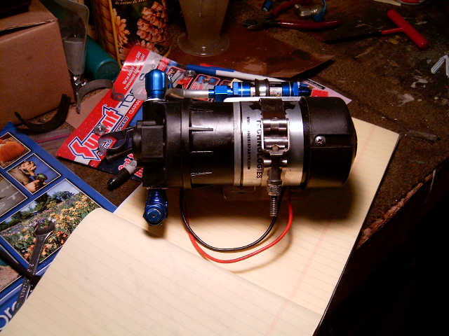

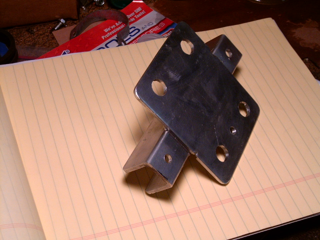

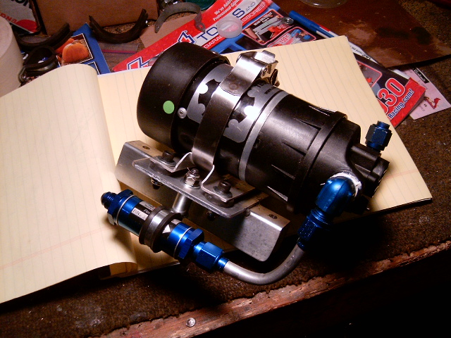

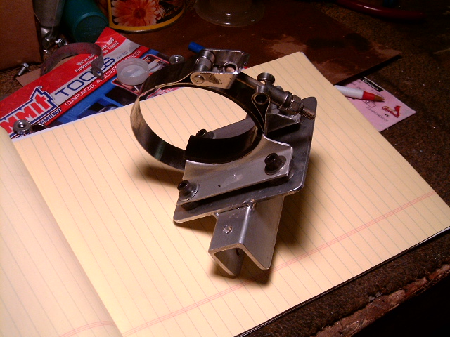

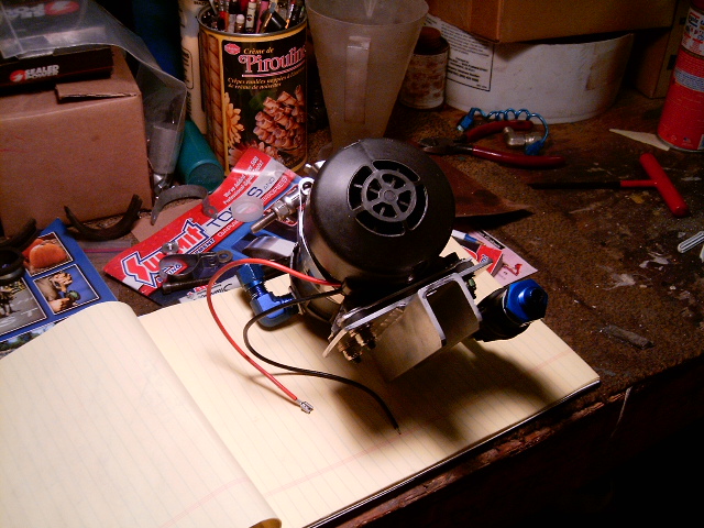

I didn't get much of a responce over in the GTD section so I just started fabing up some parts. Here's some pictures.
The first one is the pump mount and then the next couple are with the pump mounted on it. You can see the filter also. I didn't use the flat mount that came with the pump. The two little sheet metal screws that hold the pump onto the mounting plate looked like they would last about 20 mins so I replaced it with a really cool clamp mount.

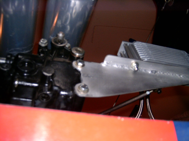

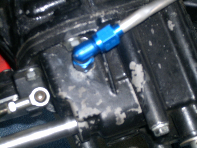

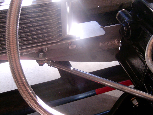

Howard Jones

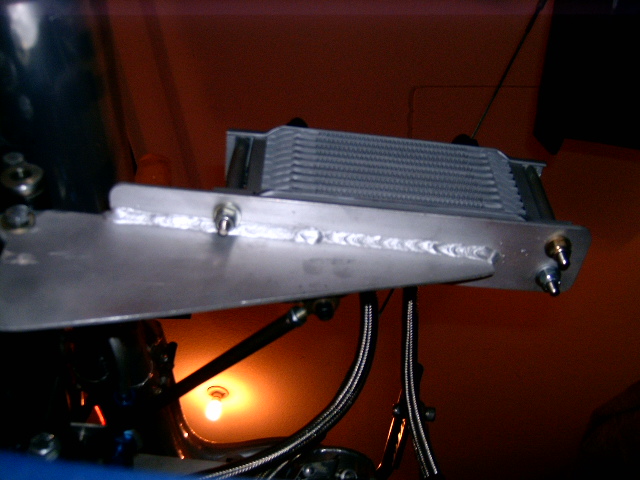

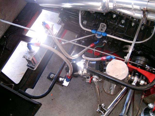

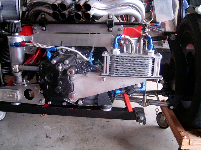

The next couple are of the cooler mount. This took a couple of tries but in the end what you see here is very stable and stiffened where I could see cracks might form. A little backyard engineering.

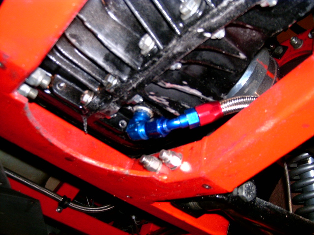

The last picture is where I pull the oil out of the box at the drain hole

Im putting a cooler on my R21T box as well. I havent decided on a place to mount the pump yet. The cooler is to one side of one radiator (lambo has 2). The air is ducted to go out via the engine bay.
My takeoff point for the oil is not in the oil drain hole but in a new hole I put in on the other half of the case. as the case is around 5mm thick, I needed more 'meat' to secure the output to. I welded a 3mm plate onto the back of the area of the hole and then run the NPT tap into that.
For the return, I done the same with the hole, eg: 3mm plate and tapped. My position for this was on the rear gearchange/5th gear cover. The inlet is aimed directly at the 5th gear, as this is the most stressed gear in the box. The theory is for the cool oil to run from one end of the box to the other.

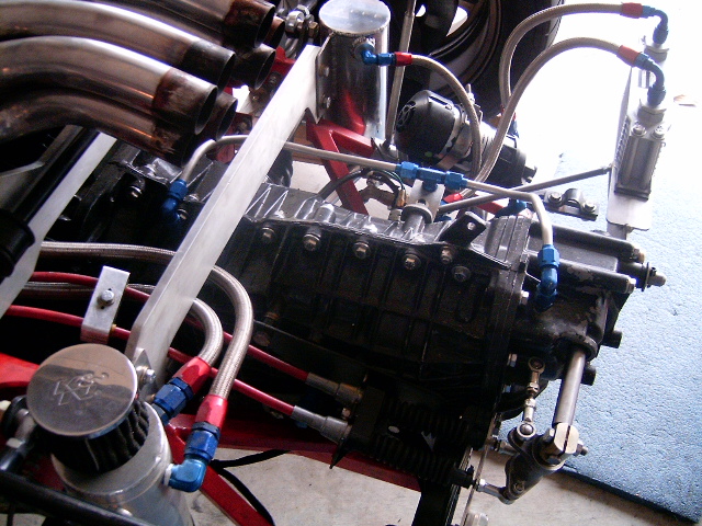

Howard Jones

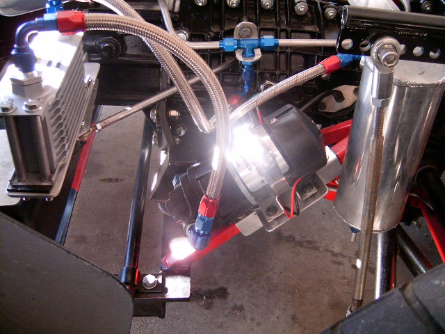

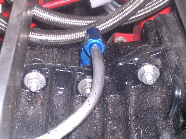

Here's a couple of shots from the top. I tried to keep all the hoses short so that there would be less weight on the fitting at the pump. The pump housing is a plastic composite material and so you need to be careful with the threaded ports.
You can see that the top of the gearbox has two return lines. One on the right returns right at the top of the ring gear. The other returns right onto 5th gear.

Howard Jones

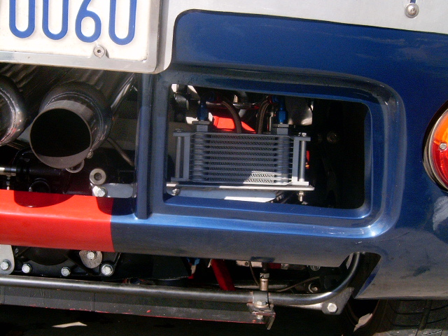

Here's a good picture of the back of the cooler mount. The webbing is added to give it rigidity and is also used as a mounting point for the brace.
The closeup is of the return to the ring-gear.
And the last one is a shot of the rear of the car. I tried to get it into the exaust air flow form the engine bay. After I get a temp gauge installed I'll see if I need cool air form under the car. If so then I will work out some ducting. There is such a low pressure area at the rear behind the spoiler that I am not sure which way the air flows in this area.

Lynn Larsen
Lynn Larsen
Howard,
Tape some 2"-3" pieces of brightly colored yarn along the edges of the vents and then have someone follow you and tell you what they are doing. It might even be interesting to have a taught piece of wire across the middle of the opening with the yarn tied to it. Sometimes the edge may cause atypical flow and the middle of the opening could be doing something quite different.
Lynn

Howard,
I was looking at all of the pictures to try to figure out how you have the reservoir tank plumbed in. Is it: bottom of tranny -> bottom of reservoir -> top of reservoir -> filter -> suction side of pump ?
Lynn
Howard Jones
Lynn, the tank you see sort of above and right of the pump is the expansion tank overflow catch can. The tuffs idea is a good one, I have been meaning to do this at the rear of the car for a long time. Just so many things to do higher up the list.

Scott McDill
Howard,
Super job!!
Where did you find that clamp/bracket combination? It looks considerably stronger than the clamps typicly supplied with pumps, filters, reservors etc.
If I am not mistaken, they are T clamps that can be ordered from most any aftermarket shop. If you are industrious you can go to a muffler shop and they should have some just laying around that you can get for NADA. Just have to make sure they are the right radius.:rolleyes:

Those clamps are excess quantity work related donations. But you can call HRP at 866-851-7223 or Pegasus at 1-800-688-6946. They are the same type that are used on Accusump systems. They are smaller in diameter all though. Many sizes are available.
Howard Jones

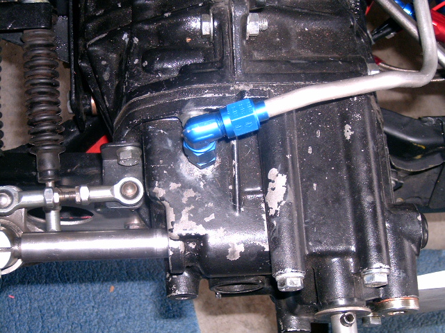

I had the back of the car off so I took a couple of more. Here's a good one of the port for 5th gear, and a better shot of the cooler mount without the bodywork in the way. Lastly a over all form the top showing the two return ports and their pluming.
