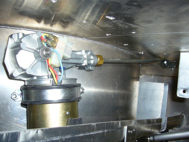

Mine is installed an operational, I mounted it under the dash attached to the spare tire well. Here are a couple pics...

No photo yet but the one Rob posted is real close to what I did...essentially a straight run to the transmission. As far as the arm I got one from my local NAPA store, and you can mount any blade length to it you may need. They had an arm assembly that matched the spline on the Lucas unit I had so it was pretty easy.
I got my motor from a Jag, but I think MG used the same motor in a lot of vehicles especially the midget which I believe had three wipers running off the same unit. The biggest issue is avoiding sharp bends and making sure the tube is well lubed and it will give good service.
The Napa part number is 60-725 or 60-750 depending on the size of the spline on the drive.
