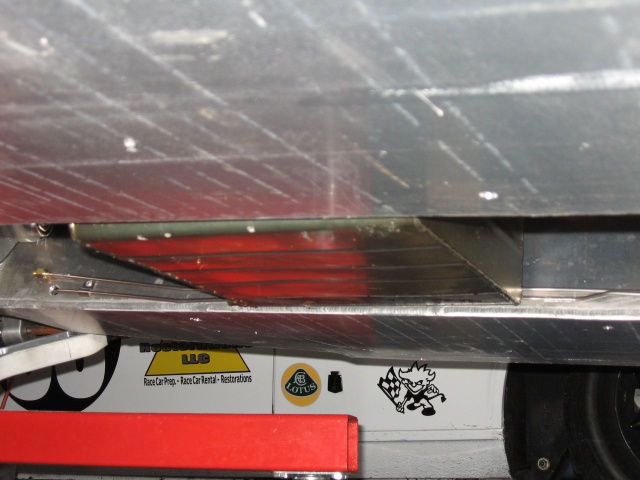

It works perfectly. Check my Lola build thread and there are pictures of it sitting perfectly flush with the bottom of the chassis.
EDITED - here you go with a picture:

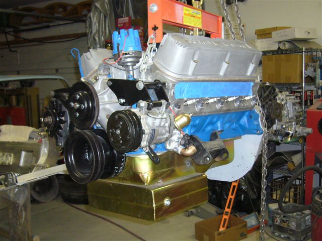

Seriously... It works perfectly. Fits ideal in all directions.
Rob
