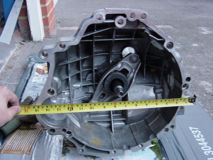

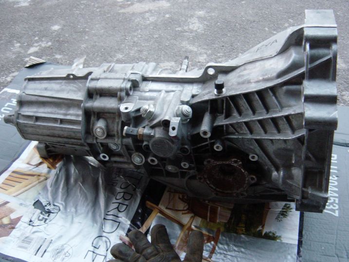

I think the Tornado is configured for the Renault. I have a GTD, which was designed for the Renault, but I am putting an Audi 01X 6 speed in mine. The box is out of an A4, and so far the Kennedy 016 adaptor plate is fitting. I still have to confirm with the flywheel, clutch and starter. My box only cost £200 and is pretty new. Mail me if you want pictures.

This is a subject that has always been up afor a LOT iof discussion. You can find 01Esw over here, but Bentley Publishers list 01E as a Quattro. I have an 01X, which is the two wheel version. They come up on eBay over here all the time. I got mine for £200 and according to my mate who is stripping it, it looks like it only has a few thousand on it.

Do you have pics? Isnt the 01X diffrent from the 01E???
