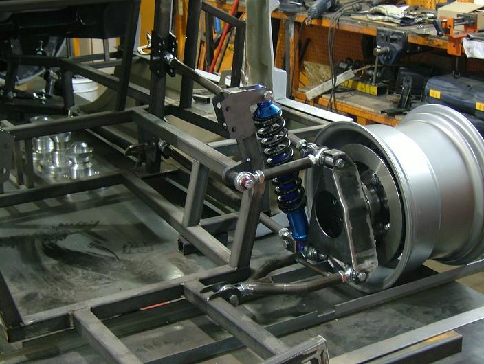

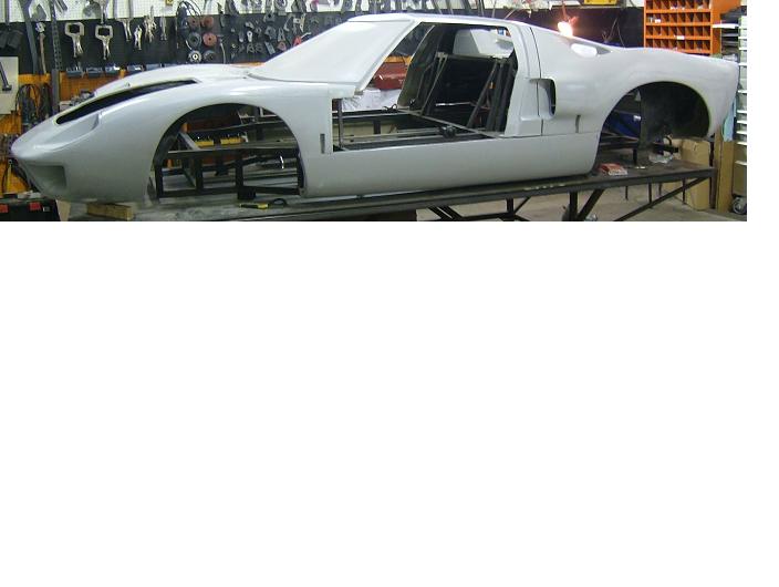

Finaly we have something to show you,we have been developping and improving our gt40 chassis and suspension for the last year.Here is a pick of our pin drive setup and rear suspension.
Thanks,
We will keep you up to date...

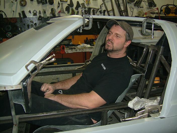

We did a lot of ajustement to fit a big guy like me in it (6.3" and 260lbs) take a look at the pic.I am sitting in the car and i have plenty of room.

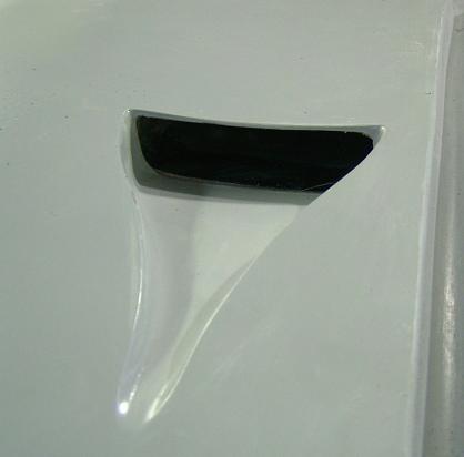

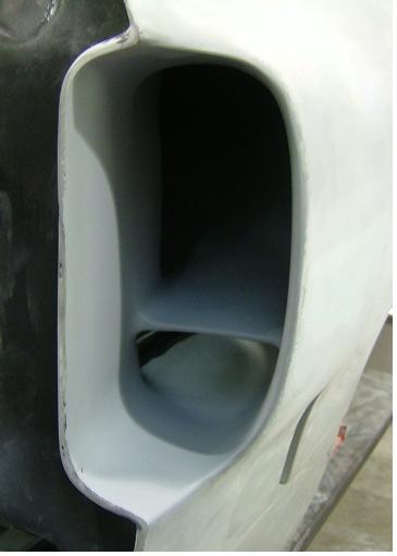

We try our best to keep the body 100% correct, so all the ducts are fuctional. The twin ducts of the back section are split like the original.
As in the picture.
Thanks,

Don, looks like some nice work. Where are you guys located? When do you think you will start production etc.? Is that a Bill Hough body? Thanks
This is Mike from Turn Ten Racing, Inc. We are the U.S. distributor for D&D Cobra. They are located in Quebec, Canada. Production has already started and the first two space framed rollers are under construction. Don has made a wonderful frame that has ample cockpit room and a lot of suspension adjustment while keeping the acurate look of the original car. The body is made by Bill Hough and very detailed and true to the original. We have been very happy with the qaulity as well. We will be updating our site as the build continues (Turn Ten Racing, Inc. - Classic Replicars (Kits & Replicas) TTR/EVO, TTR/FIA, TTR/40) and Don will continue posting build pictures here. Let me know if I can be any help. I will try to respond along with Don if time permits.

All the ducts are functional, vent the front clip has functional fresh air inlet and also front brake air ducts.
Thanks,

One questions for you. In the second picture you posted that shows the rear suspension, is that upper link attached in single shear on both ends? It appears the inner definitely is but can't tell on the outer. Any reason you didn't use double shear mounts?
Russ Noble
You're right of course Scott, but look at the construction. That is super heavy duty with a massive heim joint too! Top links are generally relatively lightly loaded and I doubt that single shear in this case is any cause for concern. I can't imagine either the bolts or the brackets being subject to undue flex. IMHO
Mind you the car is still a work in progress, there could yet be a tie bar destined for that mount. Nothing like a bit of overkill! For my mind I would like to see a wee bit more triangulation in the chassis but that too is massive so may not be required, particularly as there is no doubt going to be panels bonded and rivetted to the sides and bottom.

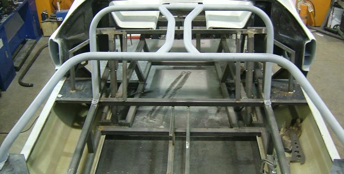

This is our roll cage made with 1.5" 1020 dom steel. It gives excellent protection and rigidity to our GT40.

Russ I agree that the parts are beefy but it appears that the lower link and forward links are all double shear, why not the upper?

The rear suspension was designed to follow the layout of the original for the most part. With a steel upright and the current geometry we believe this is the best combination and a second arm is not needed. Don will be posting another picture of the rear suspension and the specs for the rod ends and upright cross bolt. I believe ERA and others uses this type of set-up as well.
--Mike / Turn Ten Racing, Inc.

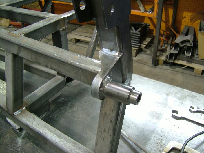

This is the braquet for the rear upper link,we also use 3/4" heim joint.
Thanks guys for your imputs.
Don.
