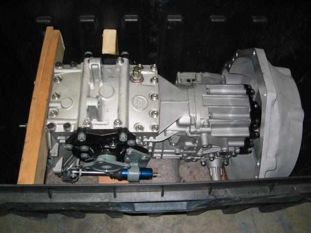

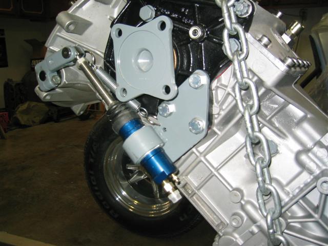

Here is the set up Dennis Quella fabricated for my GT40 ZF that he built for me last year.
Ron-
Could you PM me more info on your setup? Did you use the stock arm? What release bearing, slave cylinder, etc.?
Bill D
