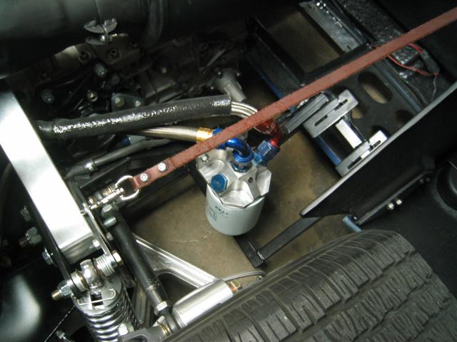

Bill, not an RCR but my filter is mounted here.
