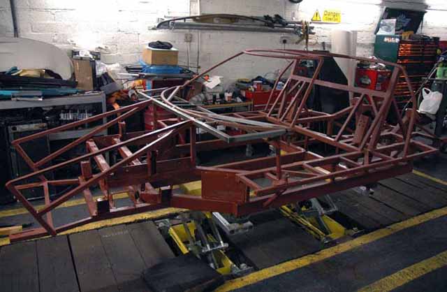

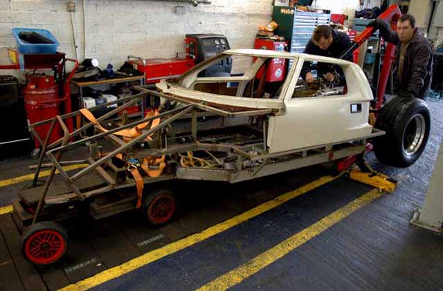

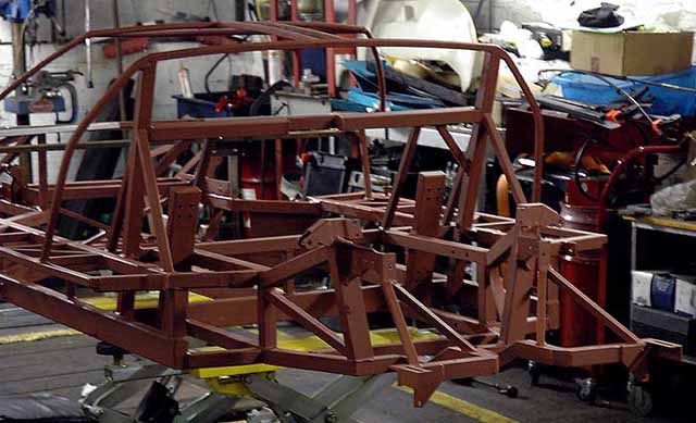

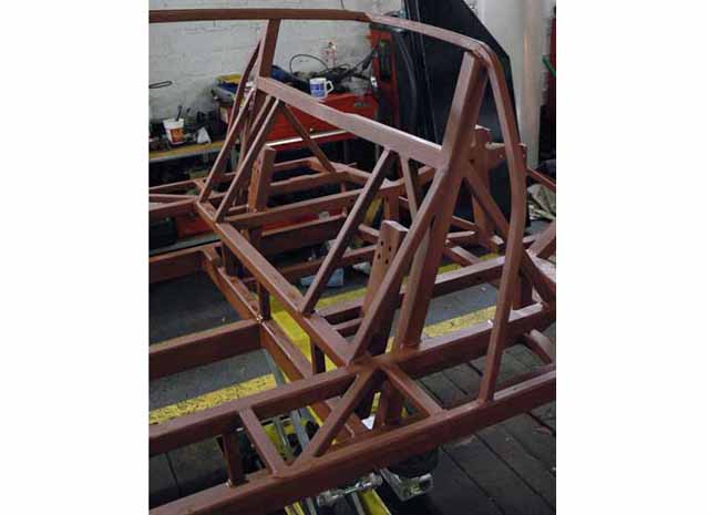

So what has happened in the last 2 weeks? Welding! Gary has cleaned up some of the joins and strengthened things up. He has also cut/welded/strengthened to allow a 2 1/2" engine drop. Below are few pictures.

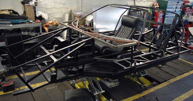

Friday... I got most of the chassis in black today. My son his starts his half-term holidays today, so tomorrow is more painting and then sorting a sump, with his aid. We are going to use a fairly standard one for the moment, with a windage tray. We will also prep the steering rack and column (Triumph). These have been test fitted.
So next week we are on for collection of the gear linkage and pedal box from Southern GT, and will start paneling once a second coat of paint is dry and hard. A set of Panels for the gtd front end came with the project, but the rest (including the bulkhead) Gary is going to make up. The first 2 questions this raises are-
1). Do people make patterns in cardboard, and test fit these? I think this is the way we are going to go.
2).We had a discussion about what to do with the sills. Checker plate is fine if anybody dares stand on it, but is rough on the elbow and hard to finish on the neatly on edges. Stainless might get stratched. Ali the same. I'm not keen on carpet that far out... So we think we are going to use thick ali and cover it with vinyl to match the dash. Be interested in opinions.

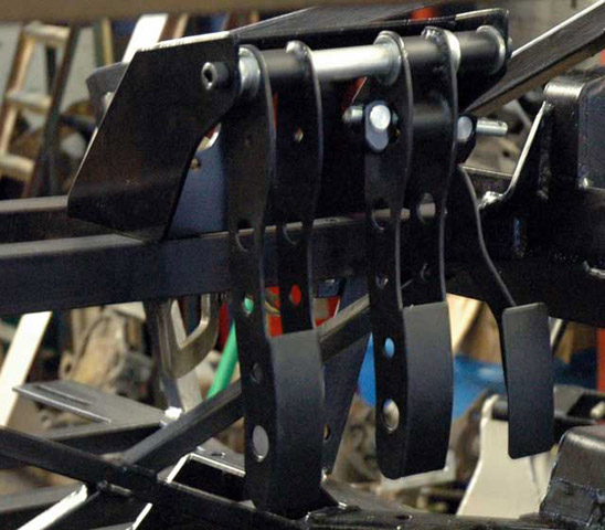

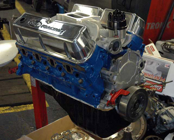

Things progress... Today I headed down to Southern GT to pick up a gear linkage and pedal box. Mick has produced what I can only describe as 'Finested Kind', and what is more delivery was faster than I could have hoped for. Many Thanks! Both items are real works of craftsmanship.
So arriving back at Bath Performance Cars I discovered that Gary had most of the engine together. Joy upon joy. My son and I have almost finished painting the chassis and we decided to place the floor pans in to work out the pedal positions, fixing points for the safety harness, and placement of the gear shifter etc. We even put on one of the door and I discovered I can sit in the car with a little headroom. I will need a Gurney bump if I'm to wear a helmet at any point.
Then there is more joy as Chris Melia says the body bits will be ready end of next week. I am fair chuffed...

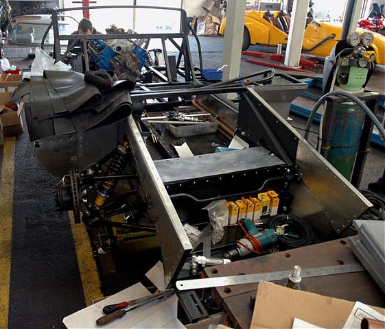

Today was all about pattern cutting. While Gary spent his time working out the layout for teh cooling pipes, I put my dress making skills to work on cutting patterns for the bulkhead and rear of the car. I got most of it done roughly... This was done in card and I will set about produing a final set of cleaned and 'tightened' patterns next week. It was very odd seeing the car rigged out in cardboard. I shall post photos when I get the chance as I forgot the camera. It really went very well. Pity cardboard has such low fire and water resistance or we could finish the chassis in a trice.

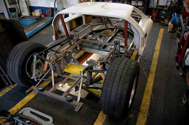

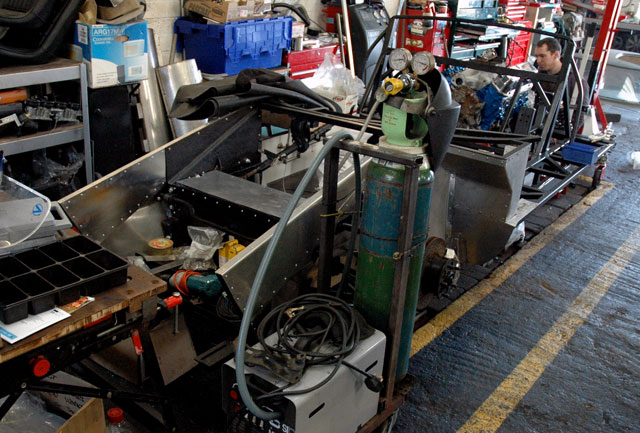

Been a while since I posted on here but we have been busy. The front end is now paneled and panels cut for the back. The gear mec. and pedal box are in and as is suspension all round. These pics were grabbed about a week ago. Since then we have mounted wheels and done a rough body fit.... more soon. Sorry about the rough pics, but mind is else where. cheers al
