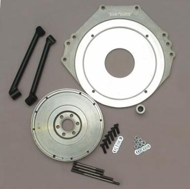

Wasn't Flatchat doing adapter plates and flywheels? I'm sure if you got his stuff he would suss out clutch info for you so you could just get those bought in parts Stateside. Freight costs might be a little higher but I bet the service would be miles better.
flatchat(Chris)
Lynn Larsen
Lynn Larsen
Chris,
Are your adapter plates dimensionally compatible with other Kennedy components? (I have a Kennedy flywheel and a Patrick/Centerforce clutch setup.) PM or email pricing if you get chance.

Sounds like a great deal, Fran.;) The flywheels are fully machined from billet 1045 steel . With every flywheel comes a pilot bearing and a list of Porsche clutch parts to be sourced (clutch plate,pressure plate,ring gear,thro-out bearing) Windsor flywheels come 28oz,50oz and neutral From the US please direct your orders to Fran at RCR:eek:
