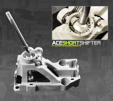

Has anyone looked into a Scion shifter? Looks like the Scion aftermarket is making a short throw shifter that may work and is very cheap. Brand new in the box from $35-$60 depending on the model. I am not sure about the physical size for mounting and I am goint to try and talk to Scion tomorrow and get that info.
Any feedback? Do you think this would work.
Does anyone know the amount of movement I would need to have front and back and side to side to make a g50 work?
Here is another shot showing the side to side linkage. I am concerned about the strength of the plastic.

The shifter you are talking about works but because it is made from plastic doesn't allow modification and is too large for the transmission tunnel in most GT40's.
IMHO a more suitable choice is Toyota's remote shifter from an 88 Toyota Tercel wagon.
They are made from cast steel, extremely simple and only 80mm wide.
And most of all very cheap from the wreckers.
I am using the Toyota shifter in my GT40 with a CMS side shift on a G50 and it works beautifully.
