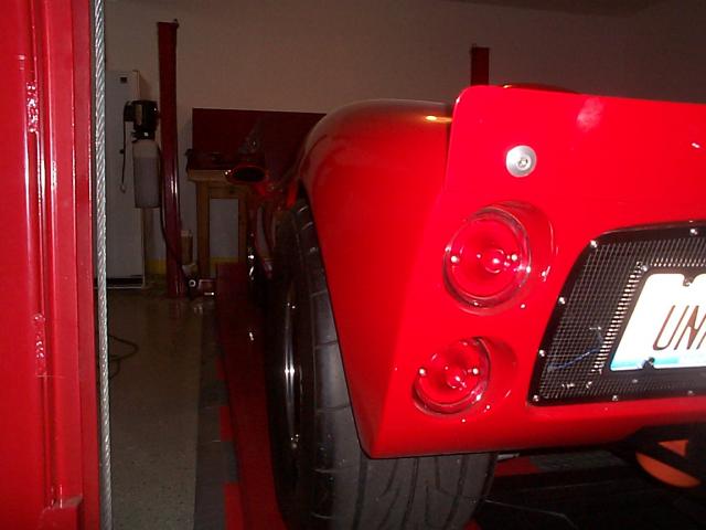

Bill, WOW! those things really stick out on you car. The SPF rear clip must be wider, because mine really don't stick out. I have the stock non flared clip and they fit with no modification whatsovever. I'll take a pic later today from the same angle if I get a chance.
i believe it will show it sticking out abt half an inch.
pic Well, they stick out a little.
The MKII rear clip is a bit wider than the standard MKI rear clip I think...
Have you ever hit a really good sized dip or bum with those tires and still no rub?
Maybe the camber scrub in the suspension will pull the top of the tire in on BUMP far enough...
