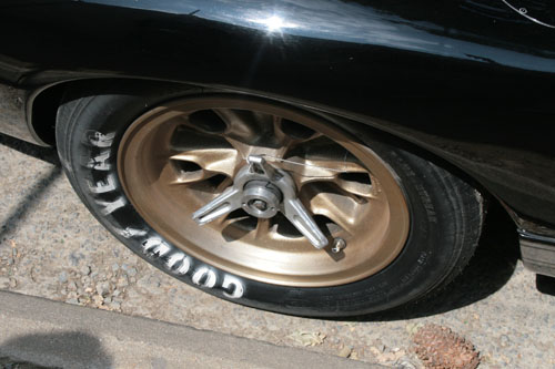

I hope to have gold wheels too and so took a photo of 1046's wheels at last years Le Mans Classic. Certianly a much bronzier gold than yours are currently, but I have no idea what the paint code is.
Thanks Brian, I have come across a Nissan Gold colour that I think is quite close, I will have to try it out and have a look.
