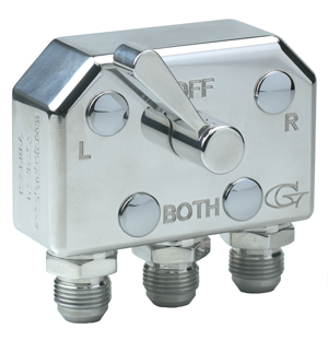

with up to AN10 fitting sizes on that selector, I doubt that flow rates are going to be an issue.. They don't sell direct from what I could find, but did find a distributor that got US $180 for that valve.. That puts it out of my reach..
Sandy
Gulf GT40
I have the one JimmyMac posted. It is a work of art! Very well made. The only problem for the folks in the 'colonies' is the expense $450usd as I recall and that was when the dollar was stronger against the Lb. It has -8 and -6 sizes as well as a bunch of other odd fittings that are available. I have the duplex valve that allows -8 inlets to the pumps and -6 returns to the tanks. Not sure what the simplex version cost but I think they may sell it at Aircraft spruce.
Sandy
Sandy
Gulf GT40
Those have been around for a while (boating supplies usually have them), I think you can also get them in duplex as well for EFI'er. But they lack the cool factor the Andair has. Neither are as convenient as the electric valves but these cars are not about convenience :)

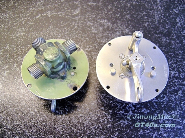

I am a newbie to multiple tank setups, so please set me straight if i have the wrong end of the stick. This thread is about tank selector valves, where does the valve sit on the car? in the cabin or in the engine bay? If the cabin then doesn't that mean fuel lines being run into the cabin, fire risk etc? or if to the engine bay then you have pop the back to change tank source?

Usually the back of the valve is in the engine bay and it mounts to the bulk head behind the rear seats where you can reach it (Just the valve lever).
Look in the photo section I think you will find a couple of shots of a similar valve in the MK3 Road car. You will get the idea ;)

Here's a couple of real ones up close.
