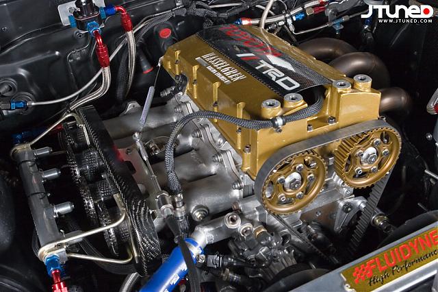

Anyone tried stainless, chrome or mylar type sleeving for dress-up of their engine bay wiring?
The sleeving coming out of the DOHC valley of Hasselgren's Toyota Atlantic motor is similar, but not quite what I'm describing. Still looks hot though.

Yes, that first photo looks rather gaudy, but the stuff can be attractive as well as very functional. It's similar to the braided loom used in aircraft, and I believe it's the same stuff that's been used for years for mil-spec vehicle wiring due to its superior abrasion resistance. With the mylar and/or chrome braiding it's also very good for heat reflection, as well as EMI shielding.
Unfortunately, despite being superior to split plastic loom in every respect, as you pointed out, it's probably not going to find wide acceptance with the '40's crowd.

If you have the funds to run a Formula Atlantic Hasselgren 4age engine like that, you sure would have the buget to go full steel-braided with those fancy red-blue couplings......
(anyone ever heard one like that on 9krpm btw? whole new meaning to LOUD!)
what I realy mean, mount the real stuff or put in stock black stuff, don't put that el-cheapo fake braiding in a 40's enginebay.

I think if you look at the photo carefully, you will see he has used hard tubing, braided tubing with the red/blue AN fittings and the loose covering to the cable pulls. I personaly think he should stick to one or the other and not mix/match the stuff. With all that carbon fiber next to it it really looks cheap. It is all on the intake side of the engine and not next to any real heat source. I vote to take it off and leave it exposed. If he is going to use it, it should be tight fitting and use the fake hose ends to end it instead of the tie wraps. But then, its not mine, so do as you please. Your the only one that counts.
