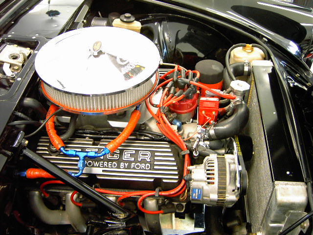

My engine builder installed a pretty nice 55 amp unit marked ND50. I am not sure that is big enough. I know it was pretty pricey but with AC, MSD, and Fans I am not sure it can keep up. Any thoughts?
