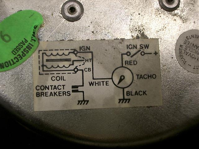

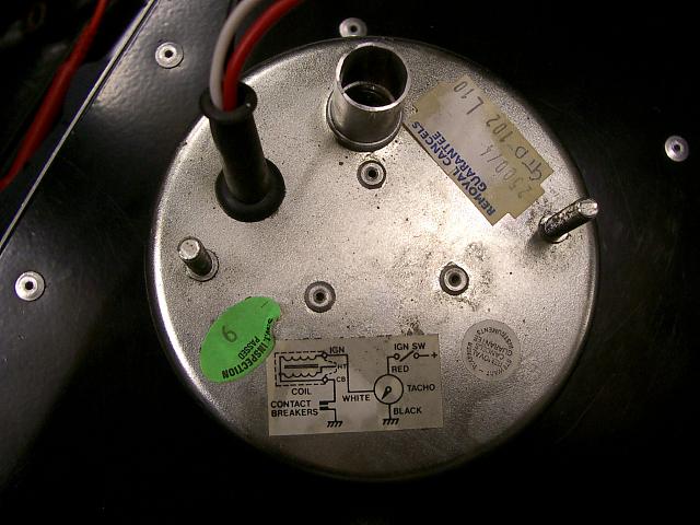

The rev counter worked fine for 3000 odd miles before i fitted the MSD ignition. Once I fitted the 6al the rev counter didn't work at all, so I fitted the MSD 8920 tach adapter.
From the diagram on the back of the rev counter I deduced the rev counter was 'Current triggered' & wired the MSD tach adapter accordingly. The rev counter worked fine for a couple of short trips (40 odd mile in total).

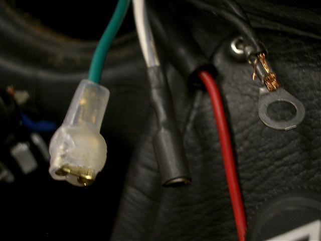

I did a close inspection of the wiring last night & it looks like the red wire from the back of the tach (which goes to green in the GTD loom????) has shorted.... however with the ignition on, both the green & white/grey wires show 12V.
I'm guessing that due to the short, something has fried... question is, is the tach adapter fried, or the tach??

When you day there is a short, how did you measure it? - resistance to earth? It cannot be a true short to earth as it goes to +12v when the ign is switched on?

I guessed it was a short due to the insulating sleeve on the green wire being slightly melted.... I'm not sure if you can see this in the picture above.....

Before you go the step of replacement, I think you should confirm what caused the current tach to take a crap. Are you sure it was the insulation on the green wire?
Have you tried to hook the tach to come other vehicle without MSD?
As the tach is out of the car at present, a test on another vehicle would be a good idea, preferably an 'older simpler' model having having just points and coil...
Also, the slightly melted insulation on the green wire could have been caused by a slightly loose connector, which in turn would be a bit resistive and then get warm/hot when current is drawn across it. So check for tightness of connections there too.

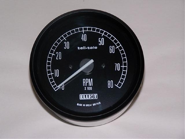

Just to finish this thread, I decided to go with the elliot tacho rather than mess around with the old GTD unit.
I ordered direct from the manufacturer & they were a pleasure to deal with. I would happily reccomend them, great service, great price & a really nice tach, details at Elliot Design
the unit fitted right in the dash, no problem & is wired straight to the MSD 6al, thus not needing the tach converter.
