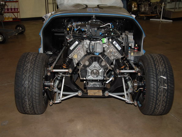

My Dad did get some photos of the rest of the car which has a Shelby GT500 engine and Ford GT transaxle in it! The engine is just mocked up in the chassis. Thats going to be a fun car!

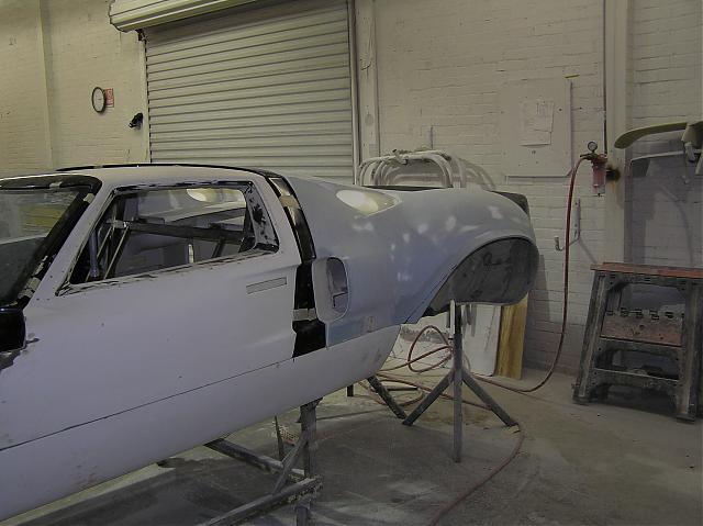

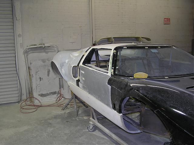

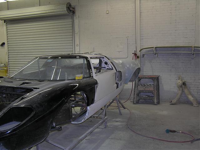

I am not completely ready with my rear decklid, I am having a mold made from an original, but not knowing your timing I can tell you if you have some time I may have some pieces available.
I have Avons on 15 X 14" wide wheels, and they fit nicely. Here are a few photos of the original piece I am copying.

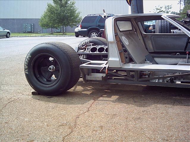

As for the wheels I kind of fell upon them by chance, and they were almost exactly the same backspacing as original Gulf spec BRM wheels....maybe 1/8" off, so I proceeded to fab adapters front and rear to do the mounting. So far I have the rears mounted and the fit is really nice. The fronts should be on the chassis in the next week or so as soon as I get some pieces in and machine them to fit.
I would contact Vintage wheels as they sell the replica BRM wheel and you probably could get them widened to suit your purposes.
If you need some dimensions for the rear deck PM me and I can supply them.
Here is a photo of my rear setup.
The wheels I am using are 15 X 10 fronts and 15 X 14 rears and were previously fitted to a March chassis. They are a six pin drive like original, but the BC is different so we made adapters and fitted them as I didn't want to compromise the wheel dimensions.
Phil

Steve, I don't know what the motivation is for the 5.4. Maybe just to do something different? I heard the project may be for sale if anyone is interested.
So, what are the particulars of this car? If this is an SPF, chassis #? Specs from factory? Tranny, etc. How far into the build are you? I could be interested...Send me a PM
Ron,
It is an SPF Chassis, not mine however. It is being built at a shop near my house.
The engine is a Supercharged 5.4 from a GT 500, the trans is a Ricardo from a new Ford GT.
