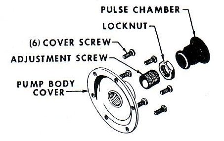

Not sure about a source for new ones (I could do with 2 myself!!) but I do have the original service manual for the pumps.
The manual states that the assembly at the top is part of the pressure regulator. It also states that the rubber end piece is a 'pulse chamber' although I cannot see any reference to it in the manuals.

I always thought that the cap only protected the threads on the regulator screw.. Hmmm...
Andy - do you have any other exploded diagrams of these pumps?
Only guessing but I would think the 'pulse chamber' covers the opening and allows air movement when the diaphram moves while regulating pressure.
You could probably just put some sort of filter on/in it if you cant get originals.
Just an observation, I may be completely out of left field........:eek:
JM

I have run SW pumps with and without the rubber cap. It does not make any difference to its operation but I would suggest that if you had a solid rubber plug it would build up pressure in the upper chamber and may well affect the operation of the pump.
