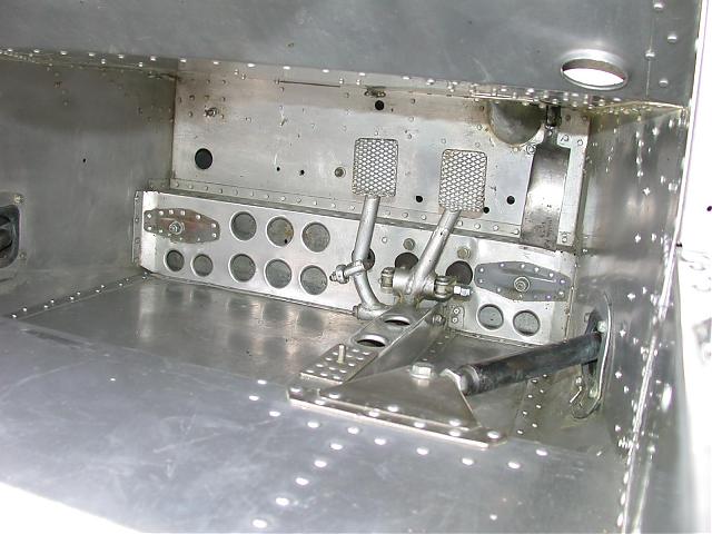

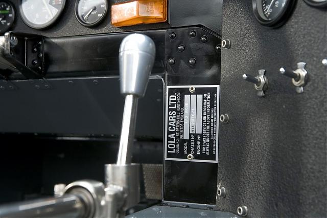

What's the radius rod looking thing in the first cockpit photo? You know, right where you would be resting your right calf if the seat was in?
Thanks, Marcus. I should have recognised them from your thread!
That is what I suspected, but I am surprised at the length. I don't think the MkIII's A-arm protrudes that far into the cockpit (correct me if I'm wrong - I'm at home and my 1:12 Tamiya is at the office).
Do you know if the 3B also had different upper A-arm mounting points/lengths from the MkIII? If not, the resulting camber change must have been useful or they wouldn't have done it. Wider front rubber and/or stiffer sidewalls perhaps?
Not sure if I would enjoy the back of my right calf getting whacked every time I turned left or hit the brakes!

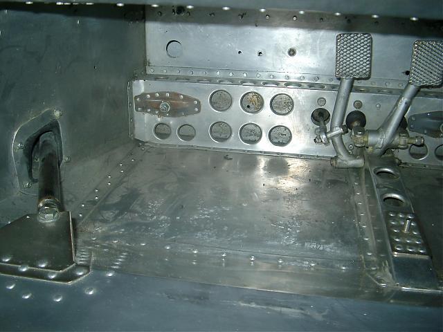

I stand to be corrected...but after having had a closer look at the cockpit pictures it seems to me as though the continuation car´s chassis is paying tribute to today´s springs and tyres (therefore higher cornering forces being fed into the chassis):
The lower A-arm pick-up points look like being significantly strenghtened as compared to original spec. Also, take a closer look at the massive doublers riveted to the OUTSIDE of the sills.
The latter already struck me when I took a closer look at Carlos Barbot´s car at this year´s SPA 6 hrs.
By "very stiff car" , I mean that the suspension does not move much when you drive it
as compared to a street car(We were talking about that front suspension rod that shares space with your leg). If you compared it to a Porsche 962, it is a mushy car.
The tub of a later Lola T332 is only about 8" deep and the T70 seems about a foot deep so Lola was not in the business of making huge substantial chassis. A Humvee comes to mind as the other end of the spectrum. Lola limp is what you got if you crashed because that suspension is going to get you leg if the wall does not fub your foot off. At the time, the chassis was considered adequate to keep all the bits in their proper places during a race. In Vintage racing or , gulp, street use, the tub will neither make nor break the experience. nothing short of a cage will protect during a crash. If a cage connected the front suspension to the rear suspension like a tube framed car, well, then it would not be a T70 would it ...

Marcus, Your bottom radius rod mounts look to have a few more parts to their fabrication than ours. Wondered what made you think they had been beefed-up.

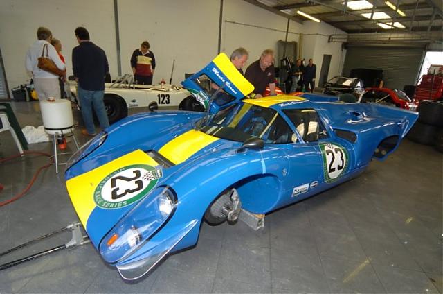

Are the presentation T703B blue/yellow and the HU76/159 blue/yellow #23 the same car? The chassis plate on the presentation car say HU76/1.
Sorry, the pic is small, but you can see it in high res at Lola Heritage Scrapbook. I would like to see pics of the HU76/161 blue with a white stripe and HU76/162 white with a red stripe.

Yes, same car . I'm trying to find photos of it when it was first shown at the motor show
with the new tag on it.

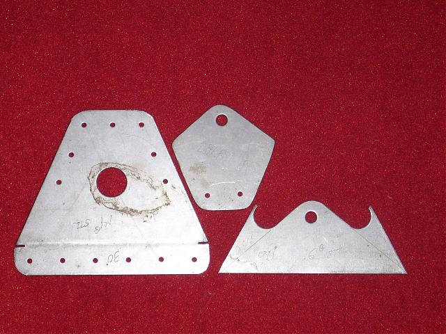

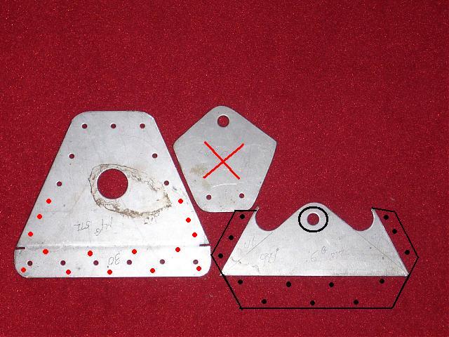

Darren,
don´t know of how many parts the pick-up points of the Continuation cars consist, but my ones are made of only three parts, see pic below. Yours seem to habe a wider base with more rivets. How are yours being made?

Hi Marcus.
Quick mod to your photo. Ours are only 2 parts. I don't think ours are any wider, may just be the overall shape of the upper part giving it that appearance. Similar shape but top plate goes to the rear to pick up on same rivet holes. Also we have a washer welded over top hole to add support rather than a complete plate as your's appear. These are too original Lola drawings and rivet pattern, always use two staggered rows when poss. Only difference on ours is under the thigh panel with added strengthening as this was the cause of more than one lost leg in an accident. Original design is REALLY frightening when you see it.

Hmmm...see what you mean.
What´s more, if you take a closer look at below pics of SL76/147´s original tub, you can also spot some additional rivet lines around the pick-ups which seem to belong to some kind of doublers underneath the pick-up points.
Am I correct?
