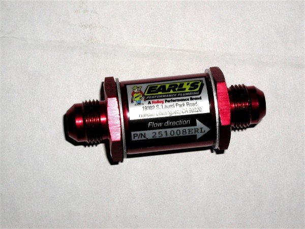

When laying out my concerns for the fuel lines, I made the decision to use one set of pumps. The cost of the AN fittings and the pumps were getting rather expensive. Since I have Fuel injection, my concerns centered around the flow of the fuel. What I came up with is very simple. The uptake to the pumps is from rear of the passenger side(LHD). Once the circuit for the fuel leaves the injectors, it flows back to the surge tank. The overflow then is routed to the drivers side tank. The two tanks will be connected via AN lines(size not determined yet). The pan of the DRBs is corregated and the line will be secured to that on the outside. I have a fear of leaking fuel in the cabin. The fill pipes are enough to worry about. The line connecting the two tanks will have a flapper valve(no resistance to flow), with the flow directed to the passenger side. Both tanks will be vented and rollover protected. The fuel guage will use a non moving sender, so I will have an accurate measure of reserve.
