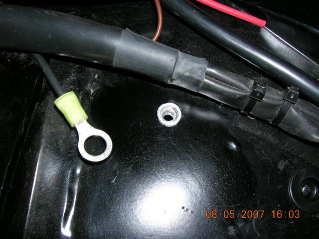

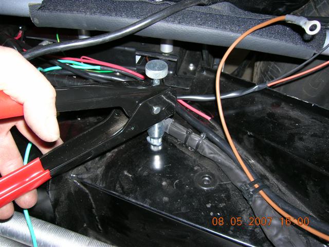

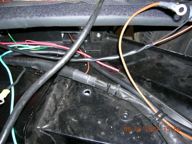

Locate a convenient place to run all your ground wires. Drill a hole and install a Rivnut. These are available from stores that sell fasteners (like Grainger). You will need to buy the application tool also. These nuts are used throughout the assembly of the SPF GT40 so this is a small investment that can make life much more pleasant when doing the install on one of these cars. The nuts and tool are basically just a pop rivet gun with threads in the pop rivet.

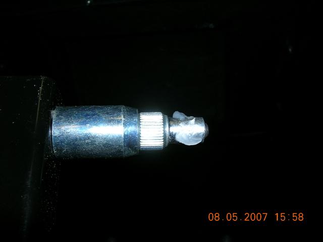

Apply a liberal amount of dielectric grease to the nut before installation. This prevents corrosion and as a side note should be applied to virtually every electrical connection on the car. It keeps water out and will maintain a good connection for years. I even apply it to the base of all light bulbs where water can degrade the socket over time.

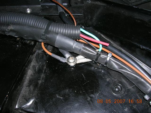

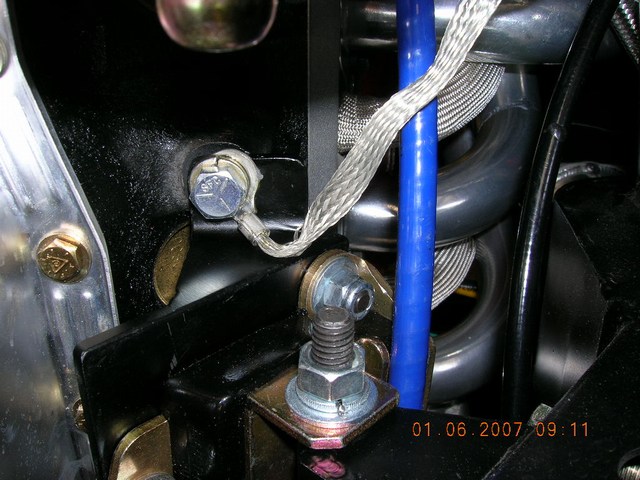

Now, route all your miscellaneous ground wires to this one point. It is a good idea to also run an engine ground to this same location.
