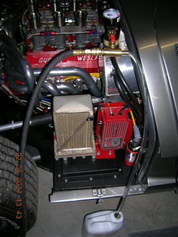

The photo below shows the air bleed tool in place on my car. The large black hose is from my air compressor and the clear hose goes to an overfill jug on the floor. The way this works is the high pressure air from the compressor flows past an orifice in the valve at the overflow tank creating a vacuum in the entire cooling system. If you ever drained a water bed you know exactly what's happening here. Once you've pulled a vacuum, you close the valve and watch the gage for leak down. After you are convinced there are no leaks (because the vacuum is being held) you open the valve the other way and it sucks cooling fluid up from the jug on the floor into the tank. Technically you are done at this point but being somewhat anal, I do the entire procedure again. Then I run the car up to full temperature to make sure there are no captured bubbles. Then I do the vacuum pull one more time after the engine has cooled a little. Doing this process with all the extra steps I take still only requires about 30-45 minutes.
