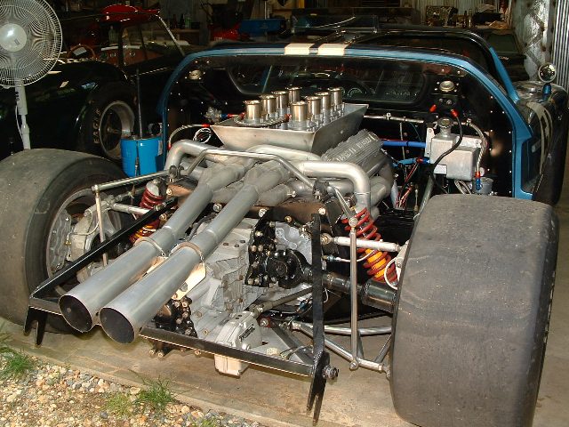

GD fit some additional silencing to their GD on some trackdays to reach the 98 db limit, these hang off the existing, ang point down towards the rear corners. Not pretty, but do the job.
Speak to Andy Burrows
Steve
All you need are some slip in silencers. They are held in place with pip pins.
Slip in a silencer, drill a hole all the way through both the silencer and the exhaust pipe, and put in the pip pins, which will cost more than the silencers.

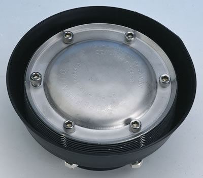

I went to Pep Boys and bought two of the type you see on the back of , well, street racer mazdas or "2 Fast 2 Furious" type cars for 30 bucks each. They work great as far as taking the car from 105db down to 98db at the local track. I just pushed them in until they stopped ( I have megaphones) and then drilled holes all the way through everything and put in some big pins. It is about a three beer job including the trip to Pep Boys, and watching "They Were Expendable". I realize the port side pin is at an angle, but so was I.
Look on this page....
Mufflers & Exhaust Tips
rodi_1989_23545868
Hi, I bought these from Summit (USA) $140 for the pair, fitting them this weekend to see if they make the difference, thanks guys
