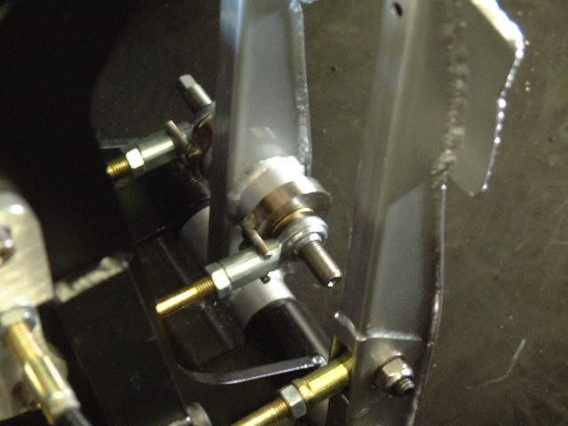

what is wrong with this picture?
Steve C
Steve
Chuck,
Take a look in the "HOW TO" section under brake bias.......
Looks as though you are missing collars that mount to ends of the tube passing through the pedal stock.
Seems you might have or had a clutch or brake fluid leak or weep from paint appearance around the pedal frame and floor.
Steve
You need another nut to make that car safe to drive:) Toss that balance bar & get a decent Tilton/Willwood that uses proper threaded clevis's on the bar.
Pat Buckley
1. You need to be more careful about spilling brake fluid?
2. That whole bias arrangement needs to be sorted out.
If the clevis ends are not threaded, then as Jac MAc says, a nut is missing from the RHS. Also, they need moving towards each other on the threaded bar - as there is too much slop at the moment, allowing them to move to the positions shown, 1 up, 1 down. Doing this will remove a lot of slop, firm up the pedal and increase braking pressure available.
Finally, If the pivot point (ball shaped lump in tube of pedal) is too far off-centre to get then required bias, then the master cyl sizes need changing. The adjustment should only need to be wound a few turns in either direction, no wound fully to one end or the other.
For SVA in UK they need to be non-adjustable (or not readily) so bar normally needs locknuts and pinning.
Chuck

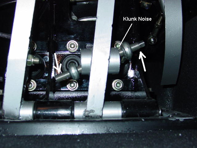

See photos below. You are missing the bias bar guides. All of the very early cars (like yours) are missing these. This is a :eek: serious safety issue :eek:. There are a number of other safety issues that need to be taken care of like defective tie rod ends that you must address also. I guess it's time for me post a list of all these issues. I have not done so to date because most of the dealers are taking care of these problems. This is obviously not the case with your car.

Lynn, thanks for all your help in informing us of issues with SPF's. Ideally SPF should be on top of all this. When they are not we really appreciate you and other owners bringing the issues and solutions to our attention. The design of this bias bar is a little strange. Certainly not the conventional Tilton type with threaded clevises.
Interesting comment Dave, the clevises on mine ARE threaded.......yours are not? The bias bar guides are in place to control the precession along the axis of the threaded rod. The lock nut I installed in my How To is to lock down the shaft so it does not move left or right (from vibration) changing the bias.

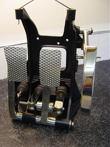

This is the original configuration with threaded clevises but my lock nuts are missing in this shot.
I also machined the balance bar with opposite hand threads for quicker adjustment.

Was thinking about this late last night, glad to see that others have chimed in. Rod ends will only work in a balance bar system if the 'ball' in the center is threaded & pinned to prevent rotation when adjustments are made. Limit stops as in Lynns pic are a help to prevent excessive tipping of the bar, but the main problem is the rod ends require nuts on both sides of them to make the system work. In the end it all becomes a bit messy & the system in Jimmy Macs pic with threaded clevis is better, requiring only one lock nut for a road car system or none if you have a remote in car balance adjuster with suitable detents etc.
In a 'normal' production car run this would be sufficient reason for a factory recall of all cars. I wouldnt want to standing in court trying to justify my reasons for installing such a system.
***** Might want to rethink that James- the principle requires that the center ball pivot should shift in relation to the clevis's- with LH/RH threads all that will happen is clevis centers will increase/decrease--- result, no change in bias :)*******
Jac Mac
JimmyMac
Jac,
I machined both threads and this one adjusted better on the day. I will give it another go however minding your advice.
