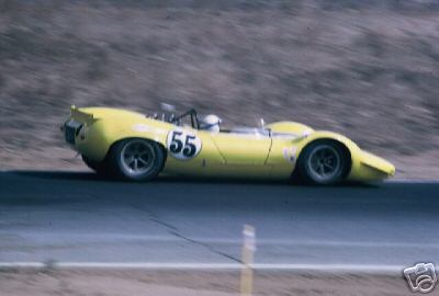

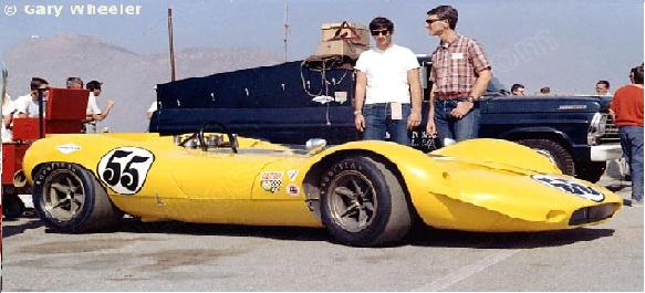

Here are some pics I found on the net. I was previously only familiar with the Cooper-Fords that the press called King Cobras, but I think the 1967 Can-Am car is really cool.
