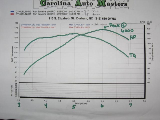

We’ve also done some motor development this year to see what we can get out of the 260Z. Here are a couple of plots. The first one is around the time of one of the earlier VIR races and we’re right at about 160 rear wheel hp and 160 ft lbs of torque. The second dyno plot is after some exhaust work was done, proper cam setup, and so on and we’re right at 168 rear wheel hp, torque the same at peak but we gave up some mid range that I'm not happy about. I’m still off the pace from the top Z cars, both in lap times and horsepower, but we’re getting there. I need to be around 175 – 180 rear wheel hp to match the top builds, but we are making progress.<o></o>
