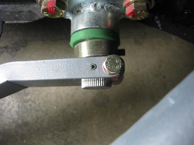

Sorry I'm a bit late to this party but this is what I found on my car. With one side of the sway bar disconnected I found when I put pressure on the free end there was some movement between the splines of the arm and the bar.
When I took the arms off I found that when they painted the arms they also painted the inside of the splines. The silver paint is very thick and soft. I went in with a scribe and cleaned every grove. After reassembly the “squishiness” disappeared. I also put in a 1/8” roll pin. Time will tell if this a good fix or not but as I don’t have a TIG welder I had to make do.
One nice thing is I can take it apart later if I need to. Mike was right, I tired taking the sway bar off and found the nuts for the two bolts are on the inside of the car in the foot box, what a pain, they should have welded them in but maybe that's the way they were back in the day. I didn't say that back in the day they didn't have their own set of issues.
If anyone is interested I drilled the arms in a drill press off the car then finished by drilling the sway bar in place using the arms as the drill guide. I found 1/8" roll pins a Lowes that were just the right length.
