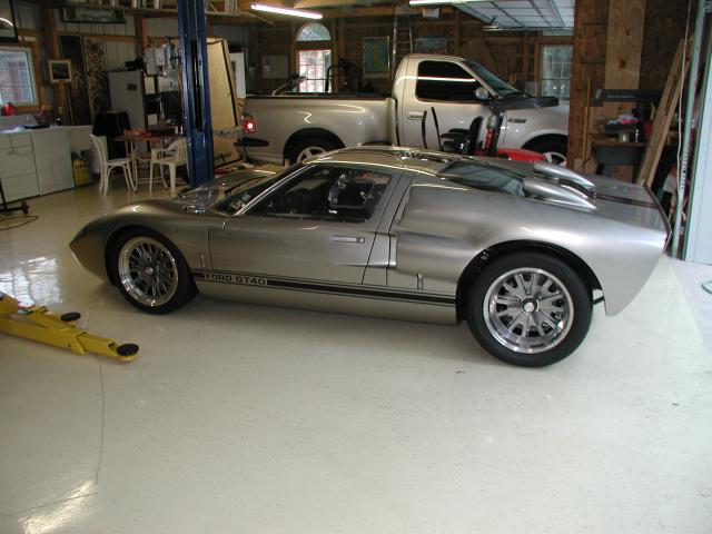

I've had this problem with my car. I have 17" wheels. With the shorter sidewalls and a bit smaller diameter (315/35/17 rear 215/40/17 front), it lowered the car about another 1.2 inches. I am having the bellhousing trimmed, the front suspension links shortened, raising the car an inch, and having it realigned. This should get the car back to standard ride height with a bit more clearance. Anyone else have 17" on their car?
Kirby Schrader
They're mostly silver
I just put 17" wheels and tires on my car. Got them from Vintage Wheels.
My ground clearance is just about the same, since the OD of the tires is close to the original 15" wheels and tires (Avons). Only the rears are 1/2" shorter in diameter, so I lost a 1/4" in height. Barely noticeable...
245/40's on the front
335/35's on the back
