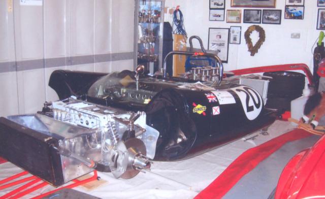

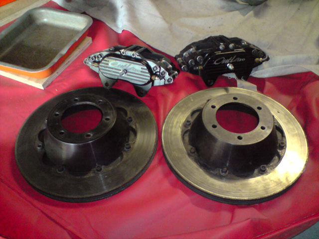

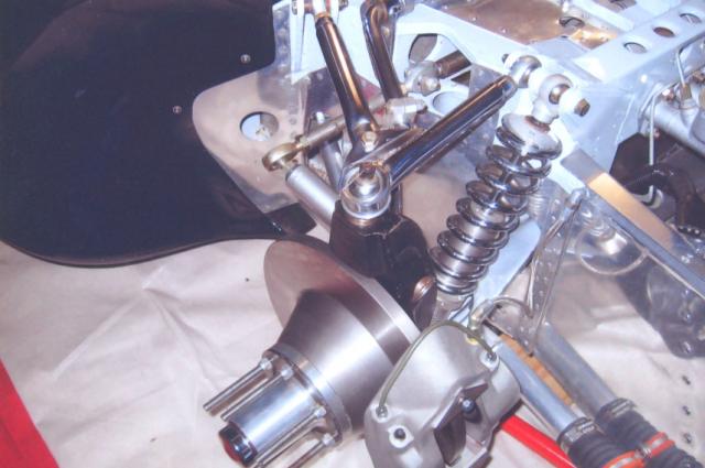

Hey Guys, Good news the Girlings have arrived and discs/hubs are all lovely and machined (forgot to take piccy today, will do I promise) and being fitted this week. What do I do with the 'as new' Outlaw brakes and vented discs? Where on earth do you sell T70 bits likes these?
The Rotors & Calipers could be used on just about any project, GT 40 or otherwise by someone with enough ability to make caliper brackets if reqd, & buy the appropriate hats for the rotors. The Rotor Hats you have will be somewhat limited in application.
How much do you want for them ? I want to buy something from the UK whilst the exchange rate is still decent !

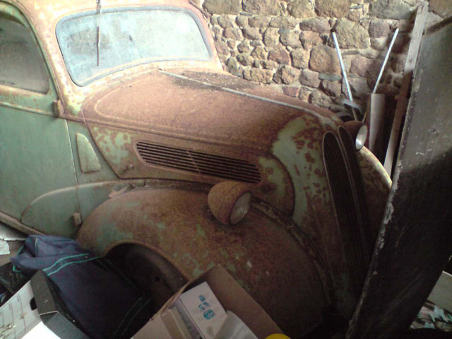

P.s Found (off topic) these cars in Jersey the other day whilst driving around, the owner of the cars it turns out is 87 and lives in a home, but daughter wont get rid of cars until he passes away (bless). she hates the cars (eye sores she called them) in her yard and I of course offered to trail them away when she calls me ! Deal done. Amazingly the Delta Integrale is solid under the moss and to my amazement there was an old Alfa Zagato Junior 1600 sitting outside rusting away. Poor thing, a real classic dying outside.

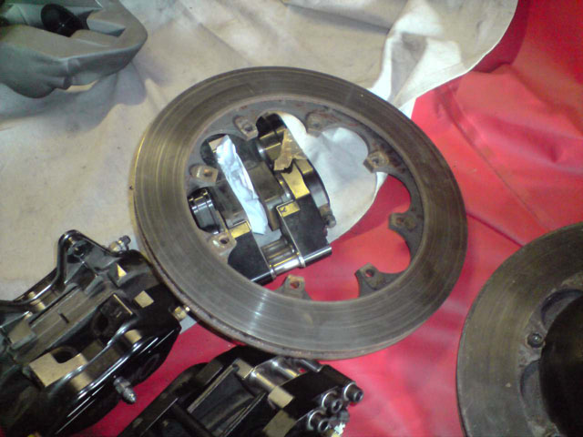

Hi, the rear calipers will arrive monday now, so only pics of the front set and sorry , forgot to take piccy before ! There a little blurred, sorry.
P.S 4 x vented Discs and 4 x Outlaw brakes, all for 500pounds if that sounds good. Let me know
