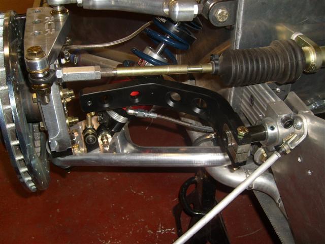

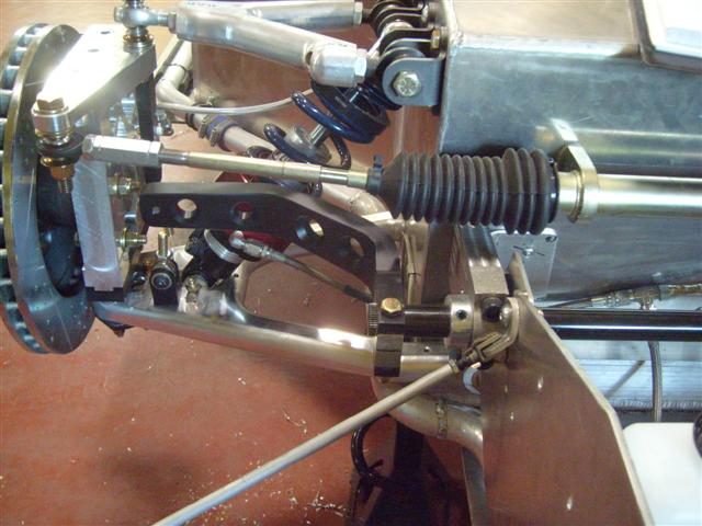

As I mentioned earlier we have a bolt on solution to raise and lower the suspension on the SL-C and others.....
This is a bolt on kit that requires next to no mods for fitment.....

Fran, I'm a little slow :) ....I'm not understanding how it works in the pictures. Can you explain?
Bill Hara
Old Hand
It looks like a motor drives the arm(s?) to rotate and pushes the wishbone down, lifting the car nose up??
Fran Hall RCR
GT40s Sponsor
You guys are seeing the front sway bar also....I knew that would throw you off....hehe...its way simpler than that Bill...
The red collar is a self contained lift system...fully hydraulic..and has no effect on spring or suspension rates.
The car can be driven with the lifts fully extended with no chance of losing height..the pump has internal solenoids and "locks" out the valving ...once initiated.
The kit can also be used on the rear of any car....
Infact we will be testing a similar package on a Viper in the near future...
Total weight for each axle, not wheel, set is under 20lbs....including the pump

We have collars with different ranges..
the ones shown provide 2 inches at the axle which equates to over 3 at the nose of the car...
But we have three inch collars ( and longer..custom) that provide even more if there is room to package them..such as lowered OEM cars with coilover kits added....
