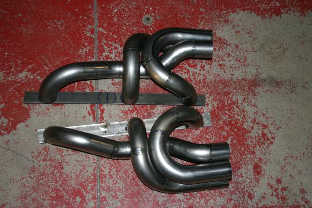

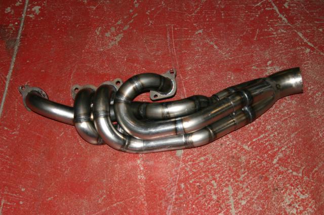

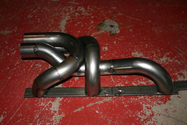

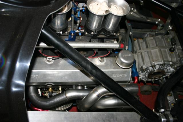

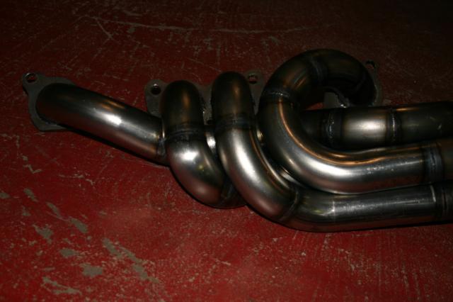

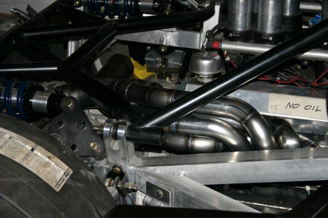

As promised here are the photos of the headers that I spoke of.

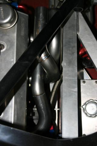

Excellent job Denny, especially considering that the dry sump 4 stage drive is on the drivers side of the engine. Getting that last tube in is always a pain though isn't it?
Fran Hall RCR
GT40s Sponsor
The spart plug locations on the 18 deg heads create trouble too.....otherwise the headers would be running downwards, and not upswept...
easier packaging downwards..

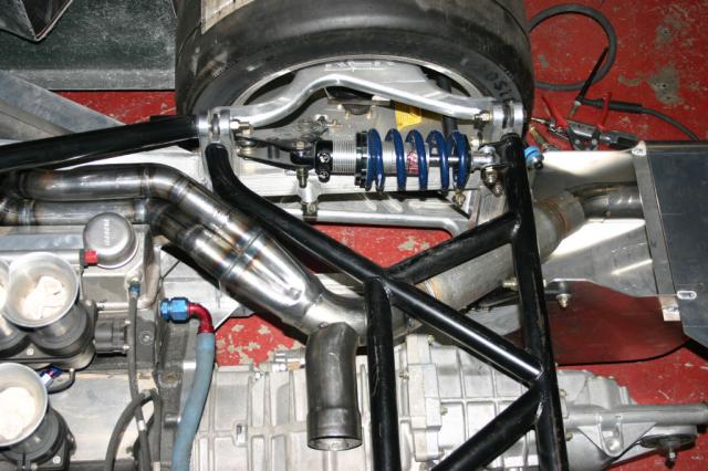

Here are the photos I promised... Have a look. :)

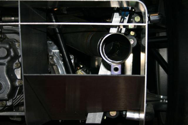

What are the dimensions of the "muffler" in these pictures. How much vertical height/ clearance is there between the top of the gearbox and the shock mount X bracing. Can a center exhaust route work above the gearbox ala GT40?
Just thinking ahead a little and drooling a lot!
Fran Hall RCR
GT40s Sponsor
The G50 has alot more room than the Ricardo box.....
We will have a look for you and keep you posted....
