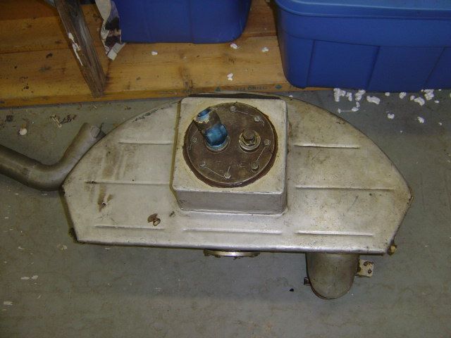

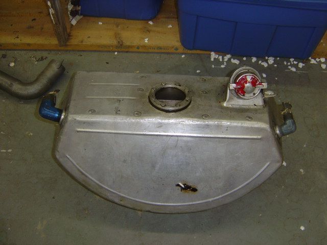

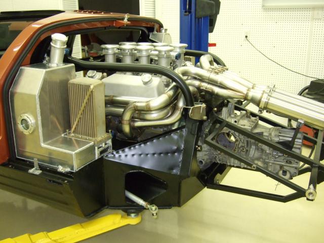

The FE powered cars(MARK IIA & IIB) were dry sump motors. Scavage pumps were part of the cast aluminum two piece oil pans. They used the standard distributor driven pump as the pressure pump. The oil tanks were located as mentioned above. The Shelby's had the tanks in the front and the H&M's had them in the rear to the left of the motor. I believe that the MARK IIB's had them all in the rear. They actually moved the tank from the left to right side depending on what track they were at. Here is a picture at my attempt to replicate the oil tank.

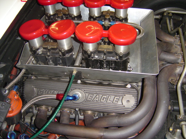

This pic which was posted many moons ago, you can see the two piece sump/pan, alloy ?heads & intake. This pic would suggest the heads were alloy as well, but remember its obviously a display/mockup assy.

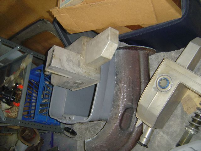

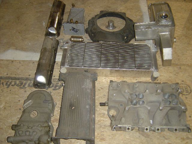

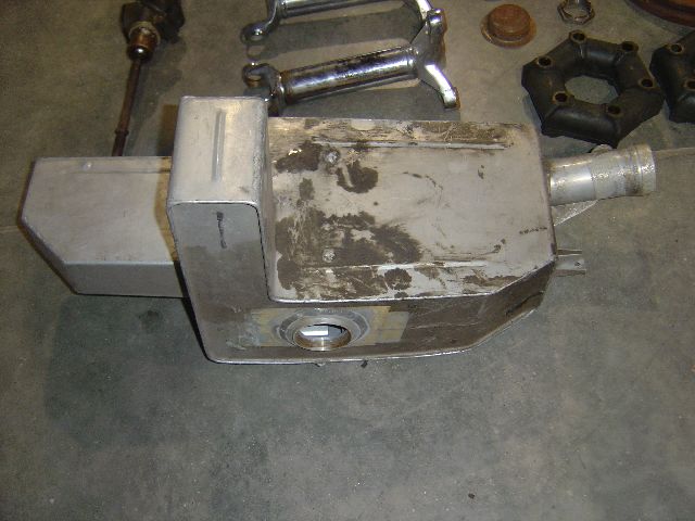

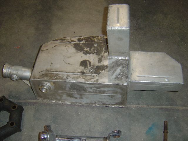

Here are some pics of my original MK11b dry sump stuff and a friends original Mk11a tank. All Mk11s were drysump.

Thanks for those pictures. Those are only the second time that I have seen pictures of the very rare right side mounted Mark IIb oil tank. Most of them were left side mounted tanks for better weight distribution. They used this tank on tracks that had more right turns than left. I learned that from the guy that probably built the tank that you have.

Points to note from Jay's pictures that most miss when making tanks:
- the front mounted tank also has a lump that sticks down into the foot well area, and is not often seen in pictures of the mkIIs as not many take pictures of this area.
- the rear mounted tank has a lump that hangs down below the top of the rear sponson. Does this protrude into the cill area ?
- the routing of the pipes through the chassis was different between the Shelby and H&M cars, not least because H&M removed the centre tunnel on their later cars.

The external scavenge pumps were stole from the comp cobras. These were only used in the very first prototype Mk11s. All production cars used the system in my pics. The Mk11b had tanks made for either side depending on the track.
Many Mk11a's as well as small block cars were updated to the rear tanks later on.
Heres a pic of both right and left side tanks as well as a few pics of 1043 with a Mk11a tank
