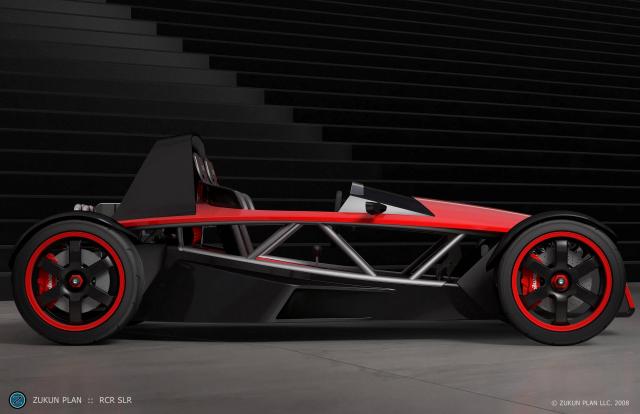

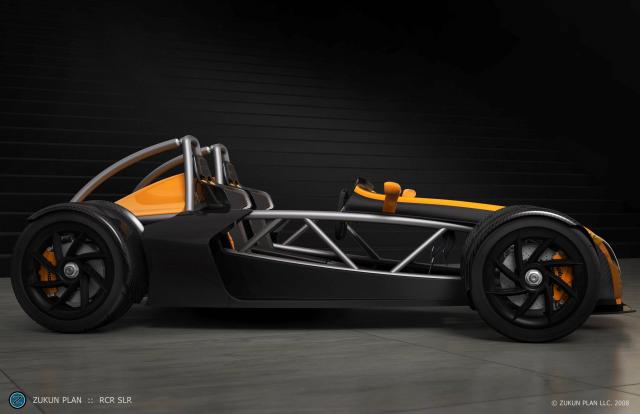

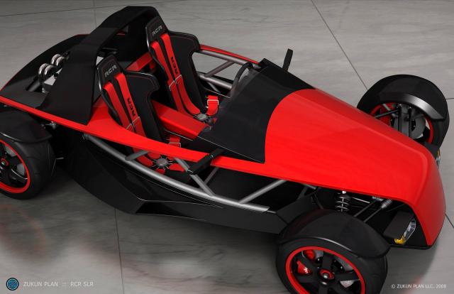

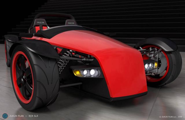

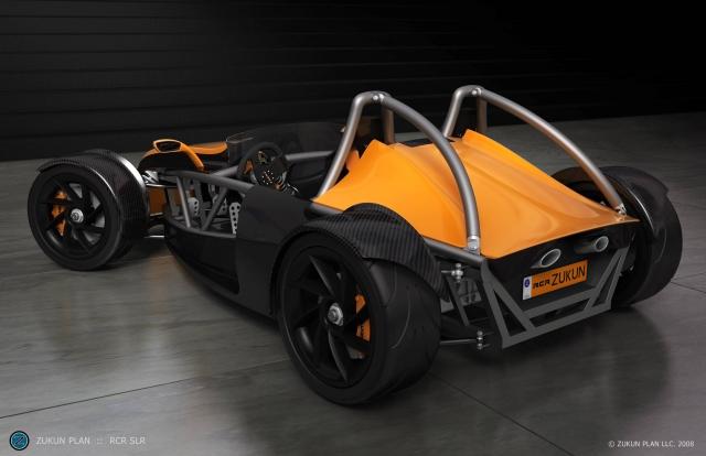

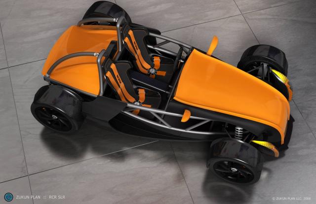

Some ideas for a higher end version of our Superlite Roadster...

Keep em coming.....we only build what you guys want to buy....
Good , bad or indifferent....lets have it.....!!!!!!

The red one is pretty freaking hot. some good design work there. Maybe a little less hot rod influence in the front 'grill' area - but even that looks cool. The rest of the car looks great. I would just like a little more race flavor to the 'grill'

Fran, the red car is awsome. Like the side panels, don't care for the 34 Fordish nose. The F1 nose would look neater (my 2 cents).

1) Headlight setup on the red car is far better than the yellow
2) Cycle fenders on both are great (much better than the current SL-R fenders)
3) Side pods/skits on both are good I am partial to the yellow (both are better than the current side pods)
4) I like the engine cover on the yellow car but would anything actually fit under that? I am still not so hot on the curved supports coming back off the roll hoops. I thought that the reason for using the curved supports was that some popular engine options wouldn't fit under the original straight X-brace. If that is the case then it doesn't look like anything will fit under that engine cover (please tell me I am wrong because I like the cover). I would like it if the engine cover went OVER the support braces. A cover should hide those as well as the engine.

6) When I fist saw the front end I didn't like it but it is kind of growing on me now. I like it better than the current F1 front end... that said I would love to see a front end like this
I also think that an engine cover like the one pictured might(???) look better and offer a little more room for an engine.

I agree with Trevor on the above Warfield design, the front end is what needs a bit of attention on the two provided RCR cars. But they are definitely much more attractive now. The red version gets my vote. It just seems to be properly finished with all the right things covered and all the right things showing. I would also agree that the headlight treatment on the red car is much better aesthetically if they are going to be out front. Maybe move them back into the body a bit like the Atom. The wheels on the orange car are great. The very front of the body just needs something somehow. Nice evolution on the R. :thumbsup: Make the car look like the Warfield though and we will take 2! rockonsmile
Perhaps slightly more rake to the hood profile on the red one (to match the dash lines) on the side view? This would also reduce the frontal area of the grill.

- I love the side scoops of the Yellow Car.
- I like the engine cover idea on both cars, this is because there are so many engine choices, the open design may be more practical. Or offer an engine cover for some of the most common choices and give the open one to those who think outside the box.
- Fenders, I like them. They look the same on both renderings. CF Fenders may be a little much, but oh well. Hahaha
- Headlights, the Red Car's headlights definitely. The Yellow Car's headlights just look weird to me.
- Spoiler, this car is crying for a nice big spoiler hanging off it's ass. I like the front & rear spoiler ideas Mr. Trevor has drawn up there. Looks mean and aggressive.
- As far as the body, I'm sorry, I'm still a big fan of the SL-R F1 nose. Craig & the RCR Australia crew did a fantastic job on their yellow car. Absolutely incredible.

The part that I'd most like to see go in to production out of the two renderings would be the fenders from the red car. The current fenders seem quite bulky and I think skinny fenders would flow much better with the style of the car.
I wouldn't mind an engine cover as long as some of the taller engines could fit (Honda), but personally would rather see a spoiler first. I like the style of the engine cover from the white and black car the most. And I'd personally put a screen in the hoops to protect people's hair getting sucked back there.
Also, I still prefer the F1 style nose to the others, but wouldn't mind some more body panels on the side and in the front. I like the side planels from the yellow car the most. And I also like that the front of the car seems much more closed off than the current SL-R.
