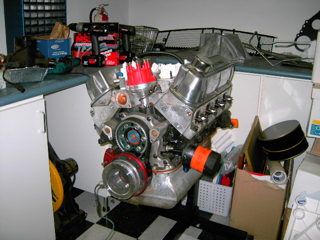

Hi, the CAV is on the way to GT40 heaven and I have recovered enough from my accident to start the build on it's replacement, #2214.
I will be using the 347 and the RBT from the CAV but will be making some changes.

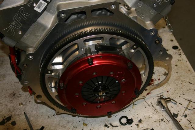

The Superformance allows the use of an original type GT40 Bellhousing (w/ mounts on the bottom) and a smaller flywheel and 2 disc clutch.
The weight of the entire flywheel and clutch weighs 26 lbs which is the weight of just the flywheel alone in my current package. This is available from Safir.
I may not be able to use my Mezier electric water pump but until the engine is in the car I won't know.

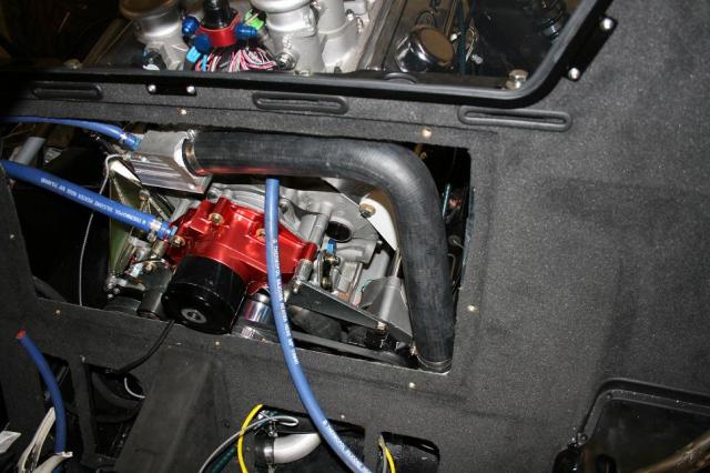

David you can use the Mezier pump but you may have to massage the area in the panel where the water pump pulleys go just a little. I have the 55 GPM on mine but wish I would have put solid motor mounts, during hammer down acceleration it will hit the area where it protrudes in the panel. I do recommend to use a bypass thermostat located up front behind the radiator, this will do away with all your cooling problems. I have 427 with bypass thermostat and have driven the car in stop and go traffic for 30 minutes with heat index over 100 and never over headed but my wife and I almost melted. The bypass thermostat eliminates the thermostat in the block and does away with the little hose between the manifold and the pump. My best friend told me about this system many years ago and its worked on ever car I have built perfect. I also recommend to plumb the radiator so the hot water goes into the top not the bottom like SPF wants you to do it. They have it backward in my opinion. As for the clutch I use McLeod lighten flywheel and twin disk with internal hydraulic throw out bearing. I use the bell housing Dennis sells. It fit together very well. I also got tired of messing with the speedo so I bought a 4 inch programmable and took out the other one. Good luck and if I can help give me a shout. You will be happy with the new rear window. :)

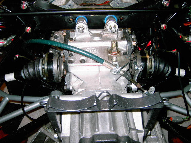

I am waiting for the parts from Safir and Olthoff but have been working on the car.
This forum has been a big help as I have addressed the speedo cable issue faced by others.
I found that the cable could not be turned and if I had hooked it up it would have failed immediately. I contacted North Hollywood Speedo and purchased the Stewart Warner 90 degree adapter and installed it on the speedo and then tried to turn the cabl;e.
It was still locked up!
The shaft in the adapter is about 1/16" too long and binds up the speedo. I removed everything again and removed a little fronm the end of the shaft and now everything works very nicely.
This might be why some of you experienced cable problems after installing the adapter.

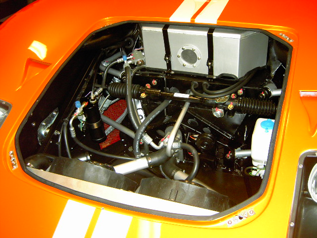

Today I am installing the fuel pump behind the LH fuel tank and the MSD box onto the battery cover on the R/side, The oil cooler on the SPF is normally on the battery box but I am moving it over to the left side where it should be.
I wil also start sealing up the holes in the firewall and the front and install some Dynamat.

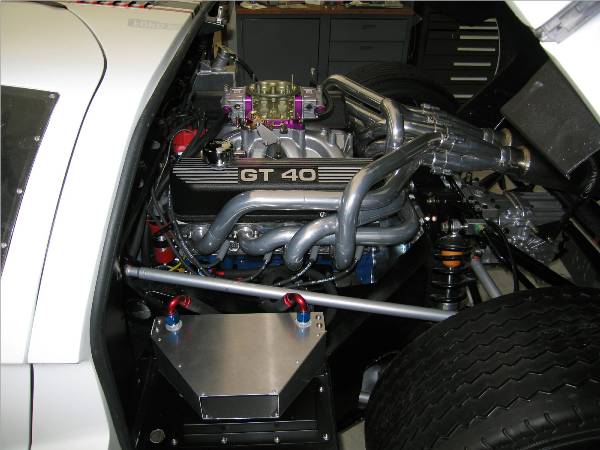

Dave,
Moving the oil cooler is a great idea. I moved mine too, makes the oil cooler lines alot shorter. Here is how mine turned out.
John

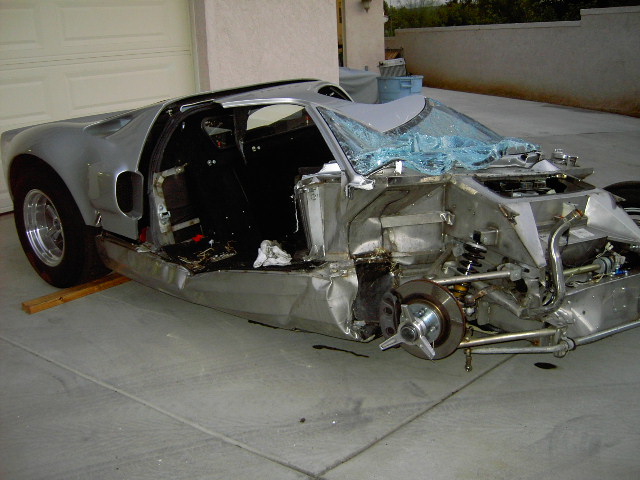

David, how do you think the CAV held up in the accident? Looks like the sill tanks took a good hit - any leaking fuel? How fast were you going upon impact? I've had some concern about safety of my CAV (ss mono) given that it doesn't have bumpers, airbags, side impact protection and potentially exploding fuel tanks.....
Great to see you're enjoying your new car - looks stunning.
Hi Cliff, the fuel tanks were full, the right sponson was collapsed and bent but the fuel cells worked as advertised, no leaks.
I think that we were going 45-50 when we hit the tree.
The damage to the chassis was pretty severe but I don't know if it would have been better if the chassis was stronger, more of the shock may have been absorbed by us rather than the car.
You are right to be concerned, none of these cars (any replica or real GT40) should be thought of as safe to drive as a modern car.
IMHO, Dave

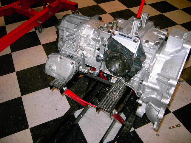

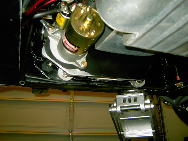

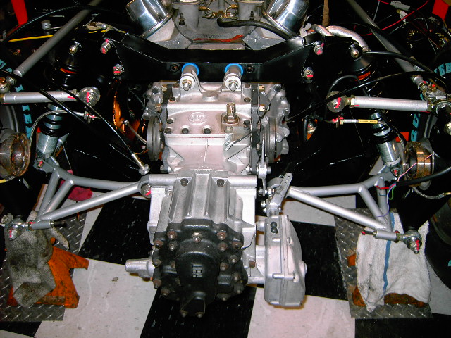

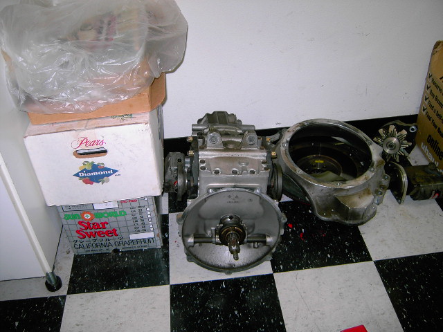

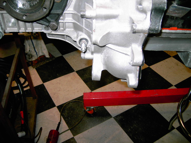

I have finally made some good progress.

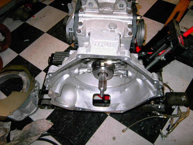

I received the Safir Bellhousing and clutch/flywheel assembly friday and managed to get the engine and trans in the chassis today.
I had to trim the ears on the bellhousing and some offset bushings will have to be made up (for the frame mounts), just as Dennis Oltoff had warned me about.
It was not difficult, I don't have a mill but I do have a 3 axis Makita and that trimmed the ears just fine.
I can now work on installing the ancillarys and finish up the wiring,
I am still awaiting the exhaust header pipes but hopefull they will be here this month.
Dave

Dave, I used a time off relay (stays on for x seconds or minutes after ignition is turned off) for my electric water pump, this takes the hot water from the engine and cools it through the radiator to take heat soak out of the engine compartment. I also used the SPF provided wire for the electric radiator fans and control them with a engine mounted thermostatic switch. If your using the cable shifter brackets that SPF provided you will have to cut and modify them, if they were on your old car then they might work OK. Are you going with EFI? Glad you are getting it put together and your doing OK with your injury's. One other thing, don't forget that pedal stop for the internal hydraulic throw out bearing, they are easy to make.

I'm a little confused on the speedo gear. I thought the RBT gear was for a 4.22 diff. Doesn't the 3.77 diff need the Olthoff adapter?
SPF are set up for 351 based motors and the recommended gear is the 3.77.
Interesting note on my car, the shifter cables are installed wrong and I will need to reverse them at the shifter.
I do have the clutch and speedo hooked up and after this weekend I should have everything but the exhaust on the car.
Dave

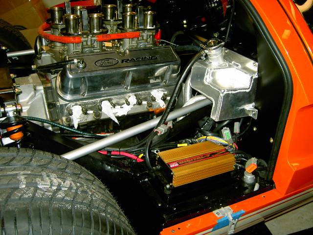

Time for me to update my build page and post some gratuitous weiner dog pictures, it seems that most of my time is taken up doing things that can't be done and the rest of my time is devoted to things that shouldn't be done.

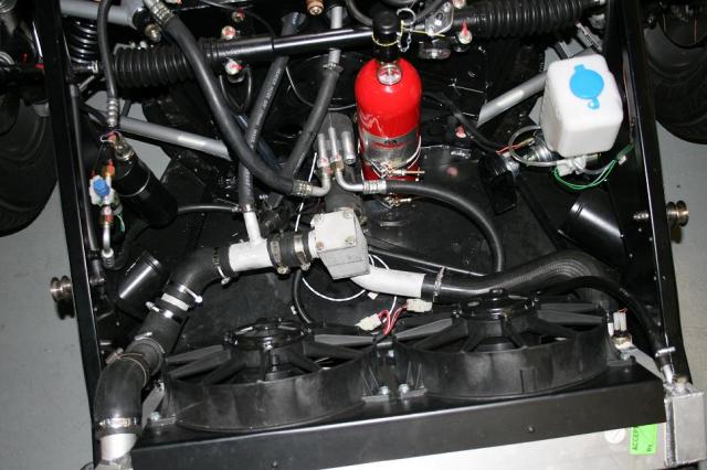

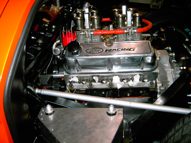

I have made good progress, I had to modify the AC bracket, I did not like the little idler adjuster and now the bracket just pivots on the lower bolt and swings the compressor out and tightens the belt.
The electrical system is close, I have to finish the brackets for the alternator and wire it and the relay for the water pump and that will be done.
Carbs are on, throttle linkage is done, need to make up the fuel line and filter, and a new heat shield box.
The tube for the water temp gauge is too short and I am not sure what SPF had in mind with the compressor hoses, I will redo them at a later date.
Oil cooler is mounted on the left side and I just need the -12 fittings and lines to connect that.
I did not use the SPF oil cooler adapter, I had a billet adapter that allows me to put a short oil filter on the engine.
The MSD ignition is mounted on the battery box lid.

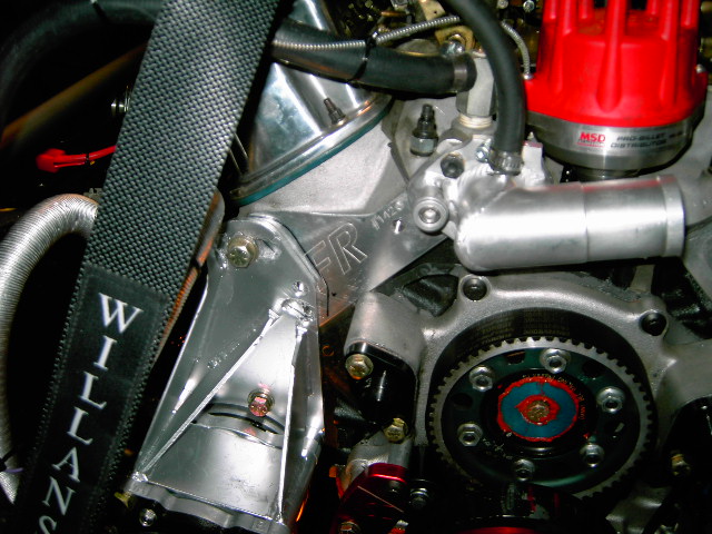

The biggest problem I have is with the Danny Bee belt drive, they used a timing cover from a 94-95 5.0 and there don't appear to be any good water pump options for this car.
I would not do the belt drive again, it has caused more problems than any other component.
My Mezier water pump is too long (different from the pump used on most 302's) and I am going to a remote pump which will sit behind the front seat.
So far I have not taken action on that item, I am still pondering the setup, it will not be elegant and I am not happy about that.
The Safir bellousing fit pretty well and will help make the car more responsive (I think).
Anyway, I think that I will be ready before the exhaust shows up.
Dave

David I had to cut 1 foot of the AC lines so they didn't get in the way, also I had to use a body hammer and lead bag to massage the area where the electric motor fits in the cover. I think that the 35 gpm pump is .5 inch shorter, I wish I would have gone with the 35 now in place of the 55 gpm I have. Check to see if that capillary tube is not bound up, its pretty long, I changed all my gauges out and when removing the oil and water temp the lines where wrapped up under the dash. If you need another gauge let me know.
