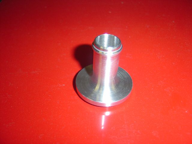

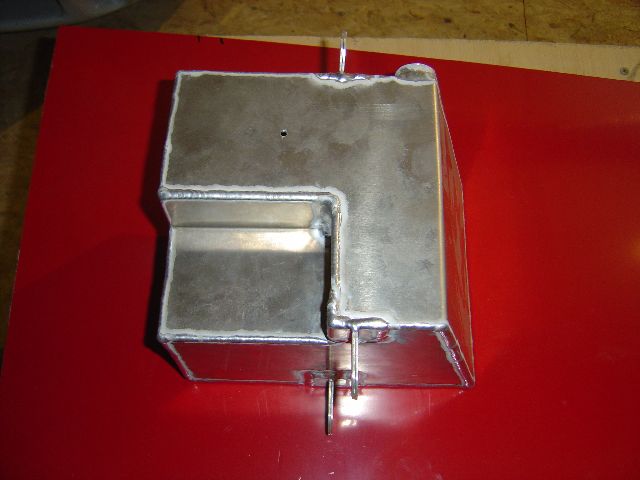

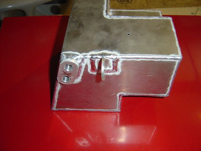

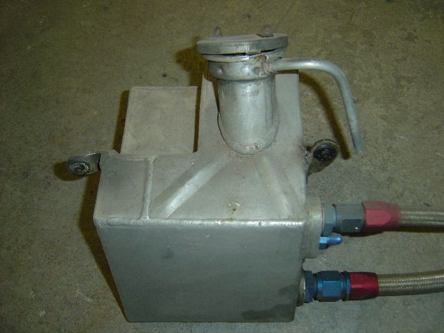

I have got the original Mk1 race car water tanks about done. These were built from original blueprints. There were 3 original versions. Basicly early, race and street. I have seen all 3 prints. I have built all the individual parts to the prints and have just struggled with fnishing the water necks. I can sell these as they are with and wiithout the mounting tabs welded on. You might need to refit these accordingly if you do not have an original car or exact copy. Email me if your interested. I also posted a pic of my original from a race car.

The originals had the top panel stamped with 2 ribs to stiffen it up and mine do not have those yet. I am trying to find a way to bead roll them in. I kinda put this on the back burner and forgot about it for awile. I have about 12 welded up half with mounts and half with out mounts welded on. I havent finished the necks yet either. I bought original necks from the UK with matching caps but they came gold anodized instead of mill finish. I also have another 6-8 cut and bent but not welded. I cnc'd all the lower fittings from the blueprint. How would you want them?

Personally I think that the shape and function is more important that absolute originality to my customers...
I would prefer them with no brackets attached so we can add tabs and make the fitment easier for our customers...
I would take a minimum of half dozen and keep them on hand .....
Doable??
