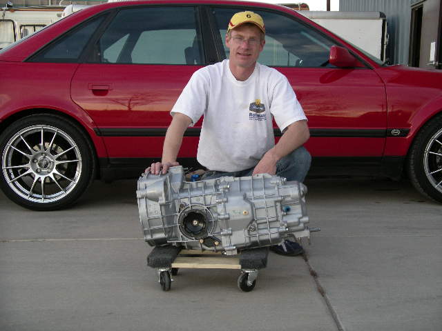

Hey there everyone,
After checking in with Fran, we have decided to offer a transaxle kit for the SL-C and RCR40.
I would really like some input on this offering so that we can provide everything that would be desired and needed for the SL-C as well as the RCR40.
Here is what I have come up with so far though.
G50/01-02 This is the short tail 87-89 G50 5 speed. $6,250.00
This is a completely rebuilt unit, carries with it a 12 month 12,000 mile warranty, has been reworked in the case to open oiling passages to allow this gearbox to run inverted reliably. It also has oil cooler in and out fittings installed.
G50 Starter $350.00
Custom Stage II clutch kit $1,500.00
19 row double pass oil cooler $200.00
Tilton electric oil pump $200.00
optional LSD (plate type) $1,495.00
Brandwood Cable Shift Kit (if needed) $650.00
Total for Kit with LSD installed $10,645.00 plus shipping
We have several of these gearboxes built and ready for shipping currently. We also offer custom gearing for these gearboxes as well for an additional fee.
Please feel free to contact me with any questions, and please by all means share your thoughts on this kit as I can only make it better with all of your help.
I look forward to working with more RCR fans, and hope that everyone has a wonderful holiday.
Warmest Regards,
Erik Johnson
Carquip Sales
(303) 443-1343 ext 2 work
(720) 980-9407 cell

Just received the G50/50 LSD tranny this PM and it looks outstanding! I'll be checking in with you re: sundry parts for mounting to my LS7, hydraulic clutch release stuff, flywheel, clutch, PP, clutch fork assembly and TO bearing. Nice placement of oil cooler ANs and fill plug. Anyone considering the Porsche transaxle should seriously consider Erik's offerings. Erik, I've loaded the core into the cooler to get ready for return shipping.
