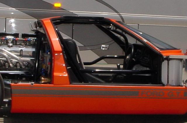

I'm working on side intrusion beams for my doors which will extend from the hinge pin all the way to the latch plate. Nothing to show just yet as I'm still in the design and material acquisition phase - but rest assured, it will be there in addition to the roll cage.

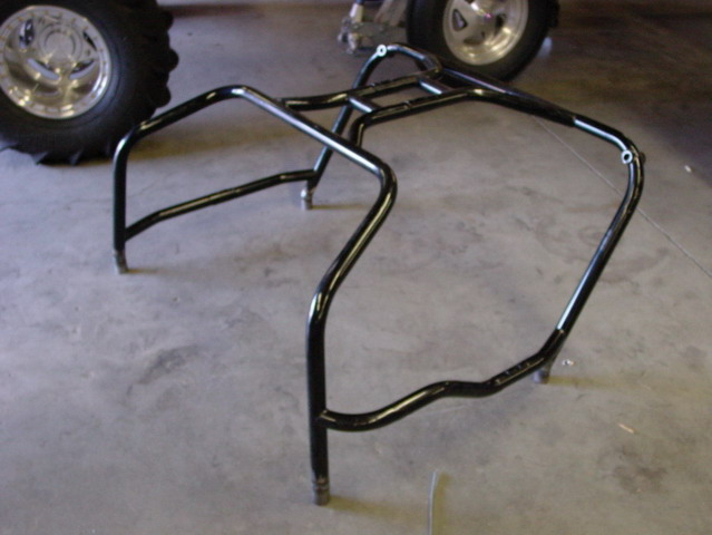

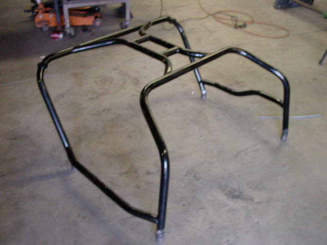

Big-foot that sounds really interesting, it would be good to see what you come up with, in both design and when finished. I've had a brief think about this and how would you make the latch at the rear of the door strong enough to support the tube in a collision?
My plans are to install a rollcage. I have also been thinking about whether its worth installing an extra brace between the front and rear hoops to the right of the driver, and left of the passenger, ive seen this done on some rollcages in GT40's and the tubes have been hinged.

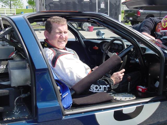

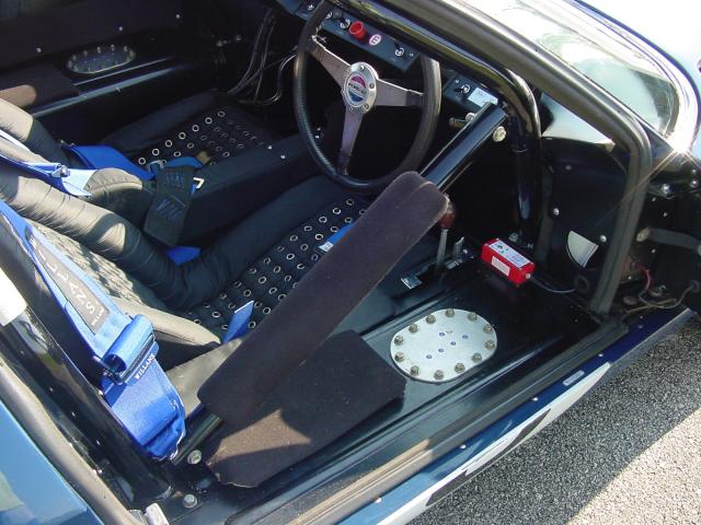

Randy, Are you planning on mounting the side intrusion bars inside the door? I believe another forum member has posted pictures of doing the same. He did a nice job, but frankly I would question the effectiveness of such a mount. To me, the fiberglass door will not withstand an impact of any great speed and I would think that your intrusion bar may become a spear and do more harm than good. I like Tim's side bar because it is mounted to his cage. Just my two cents and I will see what you come up with.
Here are some pictures of 1051. The side bar is removable.
As a side note, look at the weather stripping. It sealed up real nice.
