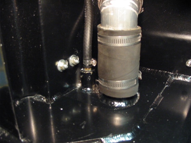

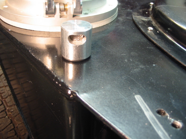

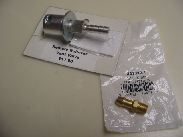

Is this what you are referring to?
The RCR has a threaded opening adjacent to the fuel filler for a vent. A 5/16” x 1/8” fitting fits perfectly.
A roll over vent valve was obtained from Street Rods by Michael, Inc. www.srbymichael.com. A 5/16” section of fuel line completes the package.
