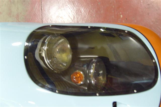

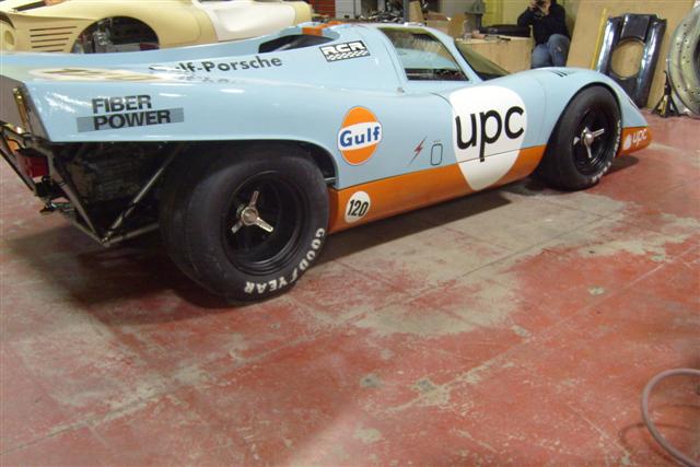

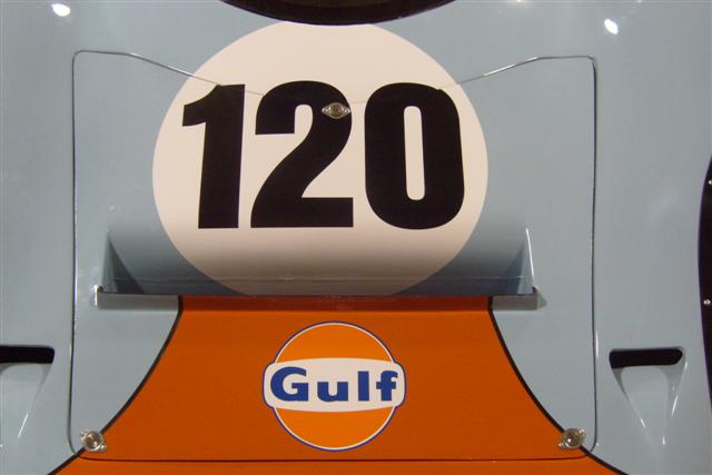

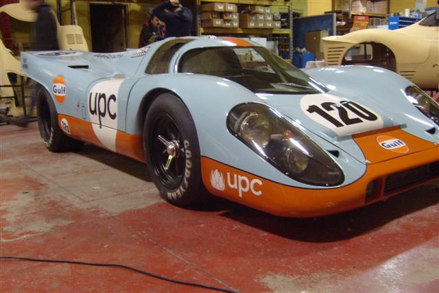

Some photos of a finished factory RCR-917 build. Just posting these on behalf of Fran.
Just an absolutely gorgeous car.

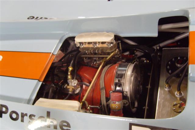

Chasis is an Aluminium tub with a tube for tube replica engine bay.
Engine is a 1980 Porsche 911 6cyl with solex carburetors. Gearbox is a Porsche 930 4 speed.
It's a fairly modest build, and to save costs the gulf blue gelcoat body has all the gulf livery added and then clear coated. So the blue sections are just clear coated gelcoat. The body finish straight out of the moulds is impressive.
Enjoy.

Gosh Darn that car is hot, although it looks like the ground clearance is a little high. I guess that's why Fran decided to offer those devices that raise/lower the GC.

does the wheels are the right one ?
it seem's that the rear wheels are not as wide as the original....
(on 1970/71 917K, the rear wheel are 15" wide
and 17" wide at the end of 1971)
is it possible to fit 15" wide rear wheel ?

most of original cars had a spool instead of a diff or a very high lock factor lsd. Due to this it was almost impossible to turn this cars around or moving them at slow speed around the paddock. The wide rear tires made it éven more difficult. For turning this cars around they always needed a car lift to move it.
For a replica which should be more usable, we decided to go the most practical way. Our rear wheels are 12x15".
Also the rear suspension geometrie are optimised on our cars vs. the original ones.
Of course if one wants the wide look of the 71 cars. He could widen the wheels to 14" and extend the wheel well further out.

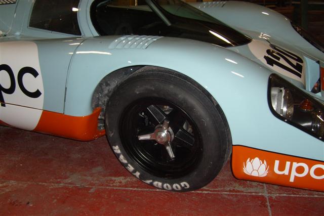

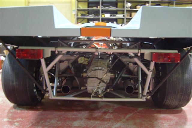

The car looks really great, but i also noticed the rear tires look a little out of place. One of the things that i personally thought made the 917 look so iconic was that view from the rear, with its massive tires tucked under the body.
Its hard to tell whats going on from these pics, but it looks like the rear chassis is a little wider, and/or the setup of the uprights may prevent 15" wide wheels?:huh:

Fran was saying a while back that he can do a tube-for-tube copy of the original for a much greater expense, but i think a lot of us wont fit be able to fit in that car so this is a nice alternative. These wheels look like the originals if you look closely (how about some high res pics, please), but they are hiding behind those knock-offs.
I do agree that the view from the rear does not look right. I think this may be highlighted by the frame being painted white and the wheels/tires being much narrower than the originals.

Here is a close up of the wheel
Take a look at this picutre from an original. They where not all as "fat tired" as you may have in mind. This one is even a 71 body with the extended rear clip, Whereas the RCr is a 70 body version.
If
Side view comparisson. No difference there
If you look close on the RCR pic you will see the engine bay cover in front of the car.
For example compare how the frame tubes are running behind the rear wheel. This looks like the real thing and due to the monoversion is much saver and easier to enter.
Put a more square sectioned tire and the octagonal central lock nut(you know client rules and if ihe wants spinners, he gets them) on it ( like a DUNLOP CR 82) and you are there.
Tom
