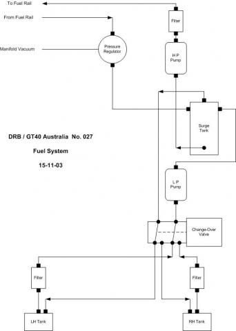

Peter Delaney
John, I used the DRB recommended 6-port change-over valve :
<TABLE style="WIDTH: 149pt; BORDER-COLLAPSE: collapse" cellSpacing=0 cellPadding=0 width=198 border=0 x:str><COLGROUP><COL style="WIDTH: 149pt; mso-width-source: userset; mso-width-alt: 7241" width=198><TBODY><TR style="HEIGHT: 12.75pt" height=17><TD style="BORDER-RIGHT: #eae6dd; BORDER-TOP: #eae6dd; BORDER-LEFT: #eae6dd; WIDTH: 149pt; BORDER-BOTTOM: #eae6dd; HEIGHT: 12.75pt; BACKGROUND-COLOR: transparent" width=198 height=17>Ashdown 6 port fuel valve 27-90106 (Harness = 27-90107)</TD></TR></TBODY></TABLE>
You can see a pic & some specs on page 7 of this catalogue :
http://www.ashdown.com.au/ezyedit/fileLib/Catalogues/general3.pdf
It basically has two 3-way valves :
- Fuel from 1 of 2 tanks in ==> LP pump ==> swirl pot
- Return from swirl pot ==> 1 of 2 return ports to tanks
The following pic shows my fuel system setup
Hope this helps.
Kind Regards,
Peter D.
