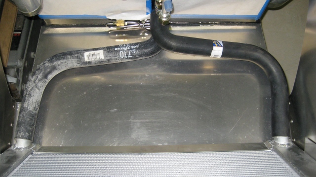

I went up to the local independent auto parts store and asked to browse the radiator hose catalog. I had some rough measurements of the distances of the openings on bottom of the radiator inlet and outlet tubes to the ends of the tubes running though the spine of my RCR 40. My mission was to find an off the shelf heater hose(s) that would easily fit a 40. I came up with a Goodyear hose (Part #60710 @ $13.99 U.S.) that will work for both sides with or without a heater core. It will require splicing in a tube (aluminum/steel with bungs) for the heater hoses if you decide to go with the heater. Should save you buying four hoses if you like the look.
I don't know what other cars they will fit. However if you have a 1.5" OD tubes for both the radiator and center/spine tubes I imagine you can get them to fit. The guy in the store said I could return them if they did not work out (uncut of course! :laugh:).

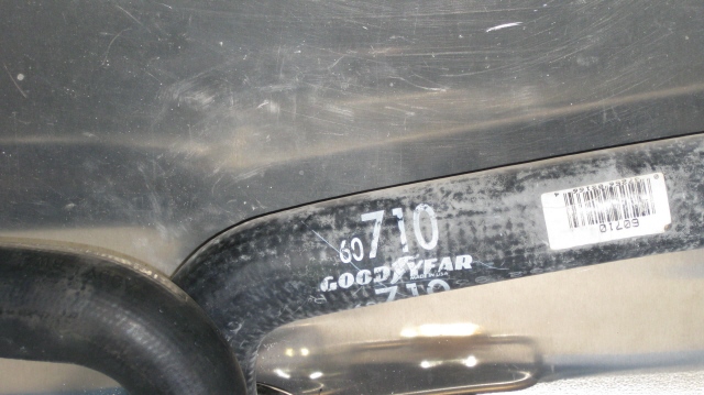

I have attached pics from my car to show the fit. The close up is upside down so you can see the hose number. I have set them in my car just for this post.
Howard

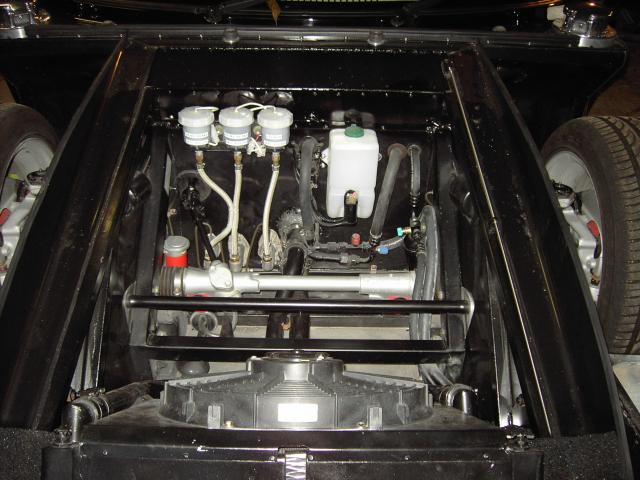

Dimi Terleckyj
Hi All
IMHO A word of warning regarding radiator hoses of this shape and length.
The longer the hose the more expansion it will have and so the greater the need for a larger overflow tank.
Also because of the shape it will have a greater propensity for trying to straighten itself out under pressure and pulling off the tube ends it is fitted to.
You would be far better off to make the bent sections in solid tube and just use short straight sections of hose to join the solid tubes together.
In my car I used pre bent sections of stainless tube cut and welded to shape and then connected to the engine and radiator with the shortest straight hose I could get away with but which still will allow a small amount of flex.
This makes replacement on the road easy as any straight hose can be cut to length and no need for locating a specific shaped hose.
If you look at the photo you can see the short hose sections joining the solid pipes both at the radiator and where the tubes come out of the front bulkhead.
Each hose section in the front is only 80mm long.
Dimi
