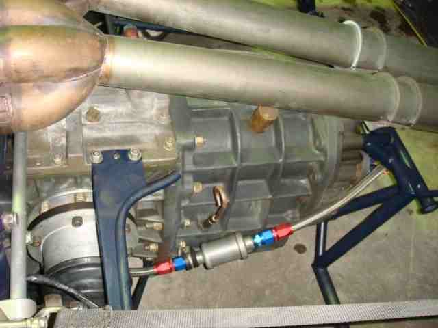

Hi Fred,
Here is a photo of my 930 transaxle. The bellhousing is custom made. They don't come like that out of the box. There is normally a flange on the front of the box that extends about 2". This was machined away in my case to fix the bellhousing. Sorry I don't have a photo of it pre-worked, as I was not the one responsible for doing it.
Anyway, hope it helps.
Martin
