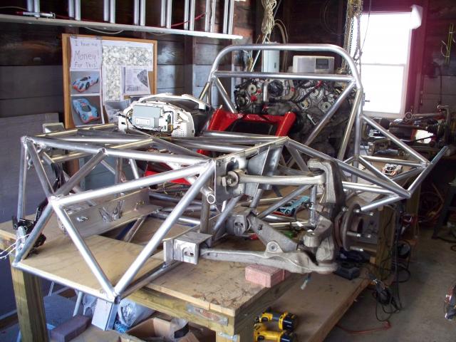

Hi Guys and Gals,

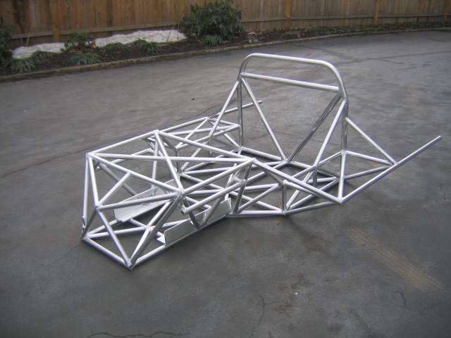

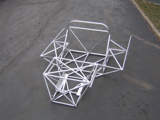

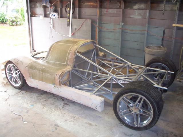

I desided I couldn't afford to build anyone's kit car for track days so I picked the car that was my favorite, the 917K or LH (can't make up my mind which), and build one from the ground up.

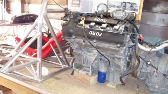

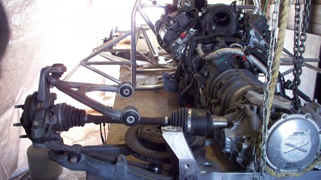

The chassis is all aluminum tubing, (had to have aluminum), and the drivetrain and suspension are from a 2004 Cadillac XLR that I purchased on ebay with only 2400 miles on it. The "Ford" name on the engine is a joke as I was going to use it as a "Cosworth" for a 6 wheeled Tyrrell that I designed but it would have cost too much.
I am having a race shop do the welding and I designed the engine and transaxle connection pieces that I'm having a mechine shop make and modify.

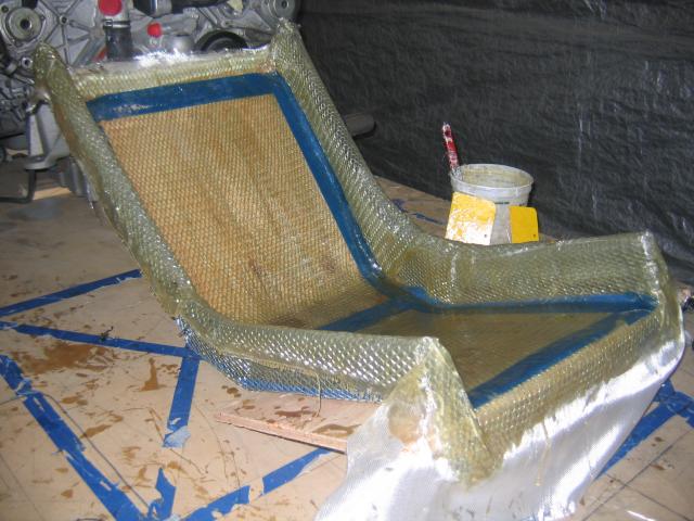

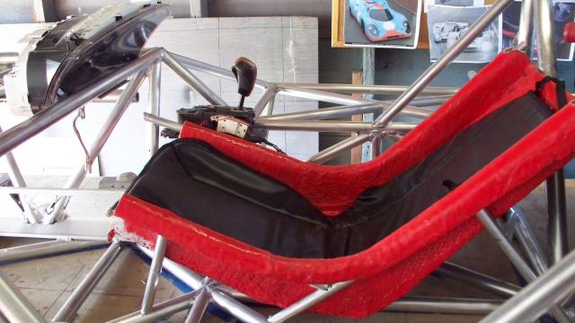

The seat was my first try at fiberglass work and the experience is valuable as I am making the body myself.
I'll send more pics as work proceeds.
Enjoy,
Jack
For some "Security" reason the photos didn't go through. I'll try again.
Sorry,
Jack
Here's one. I think they're too big.

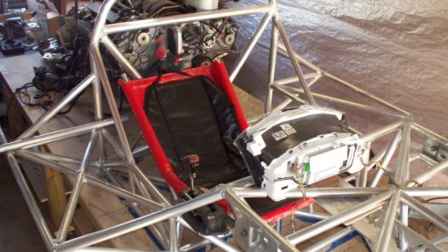

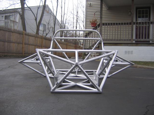

Here are three more photos.
and a few more!

I stepped back, took a look and said, "Looks good to me!" I just made it look like race car geomotry and the race shop that's doing my welding will do an alignment and road race setup and I'll do skid pad and testing. There's a lot of adjustment and I can always change anything on the car.
Jack

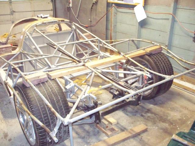

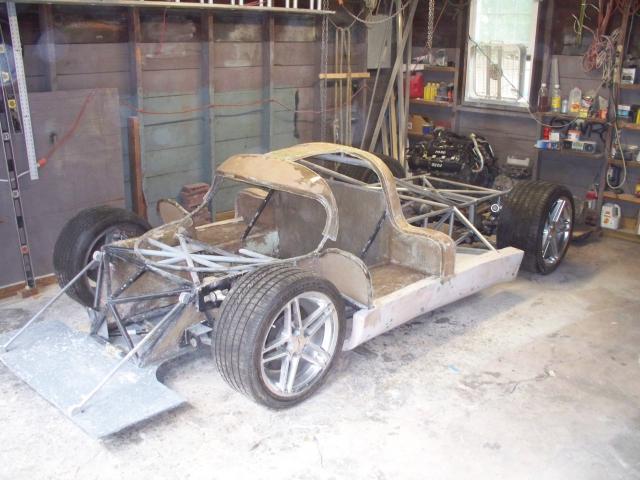

Hi Guys,
It's been a long time but I had password problems and I've been busy.

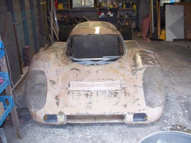

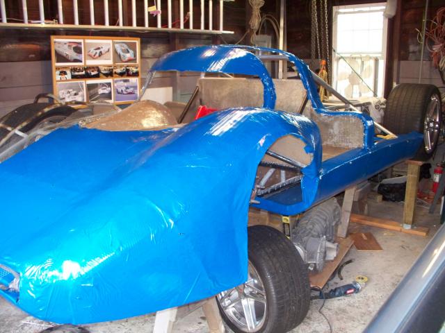

I've always dreamed of lying between the front tires of a Long Tail Porsche 917 hurtling down the Mulsanne Straight at 236 mph. (Kind of an escape from life). I sat in the car, on the ground for the first time, this morning and started to experience that feeling.
As you can see from the photos, the chassis is done and the body is pretty far along except for the tail. Notice the "Ground Effect" tunnels on both sides. They are for directing under car air to radiators attached to the triangular tubes in front of the rear tires and I will have NACA ducts on top of the tail. The roof had to be 3" taller to accomodate my 6' frame and extra large head with helmet. The nose is designed after the LH with a K air exhaust, the waste and cockpit are from the K car and I will make a shorter long tail to better accomodate it's end use.
At this point 9 months of unemployment is catching up with me and I don't want to borrow any more money for the steering, coilovers, fuel cell, radiators, exhaust system, etc. I will be focusing on finishing the body, interior, door hardware, lights and electrics in the front of the car.
I've desided to build the car for the street and try to register it with "Antique" plates. I probably won't get enough seat time trailering to track days or hillclimbs.
I'll send more pics when it goes to primer.
Jack

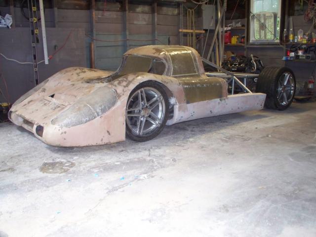

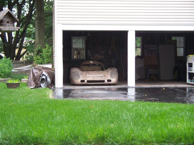

Here are the latest photos of the car.
Jack

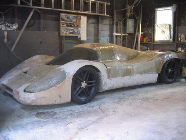

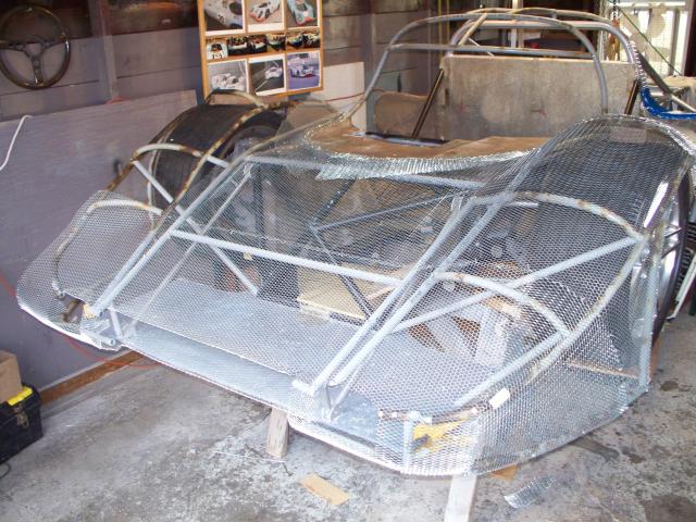

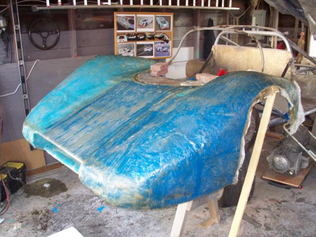

Hi Jack...I'm impressed as is every body who has viewed your build, I interested in your method of construction for your body. Correct me if I'm wrong, but it would appear to me that you are hand laying over a stucture that is the shape you want and then finishing the final shape and smoothing it out with body filler. You don't appear to be taking the body from a Mould as such. If this is right, what are you forming the shape of the body with and does it become part of the body or is it removed once the glass is cured. The reason I am making this assumsion is the surface on the body looks like raw layered glass and not the finished gelcoat you would expect if they had been pulled from a mould. The other reason I ask is I have to make a body for my scratch built project in the future and I'm always looking for good/economic ways of construction.
Cheers Leonmac.

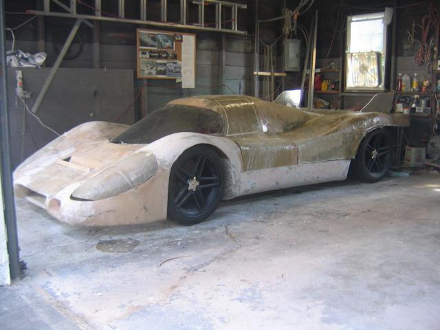

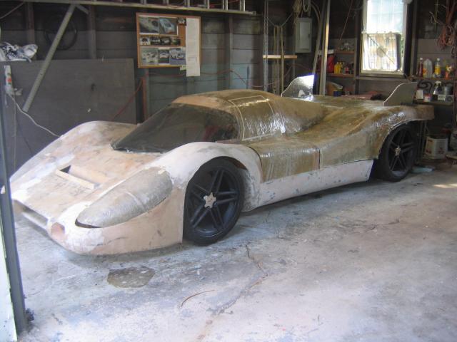

Hi Guys,
I was thinking of painting the car a dark gray with a lighter gray "Gulf" stripe down the middle and around the sides. It will probably wind up Porsche "Grand Prix White".
All you have to do for the widshield is bend a piece of Lexan over the frame, scribe it and cut it. Haven't figured out how I'll attach it yet.
The attached photos show how I formed and layed up the body. It was quick to a shape but massivly time consuming to finish.
Notice the "Naca" ducts to cool the radiators on both sides and the Fin I formed today.
See ya,
Jack
