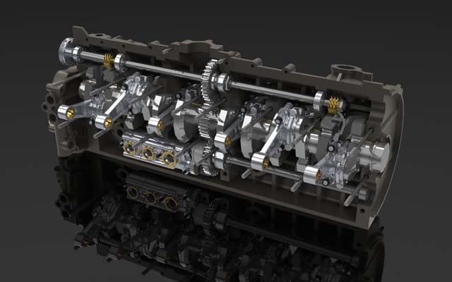

I thought some of you might be interested in this. The 917 engine has always intrigued me, so several years ago I began modeling the engine using 3D design software. This is an rendering of a portion of that solid model.
This is a result of quite a bit of research, including a trip to Stutgart last year to take detailed pictures of the 16 cylinder version on display at the Porsche museum.
I currently have about 90% of the engine modeled down to every nut bolt and washer. I will post more images in the future.

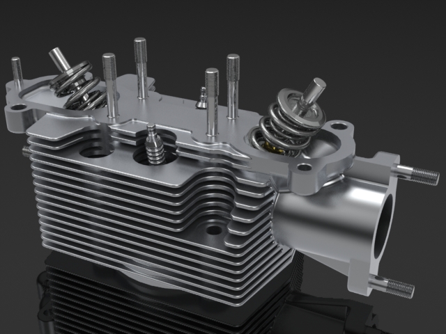

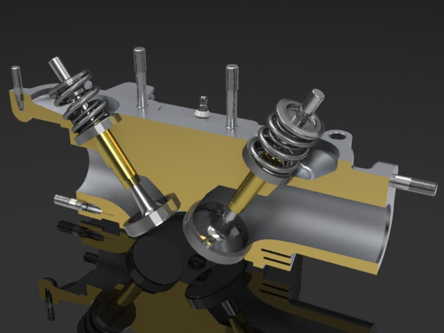

Here are a couple more rendered images of the 917 engine. One is the head assembly the other is a head cross section.
Mark

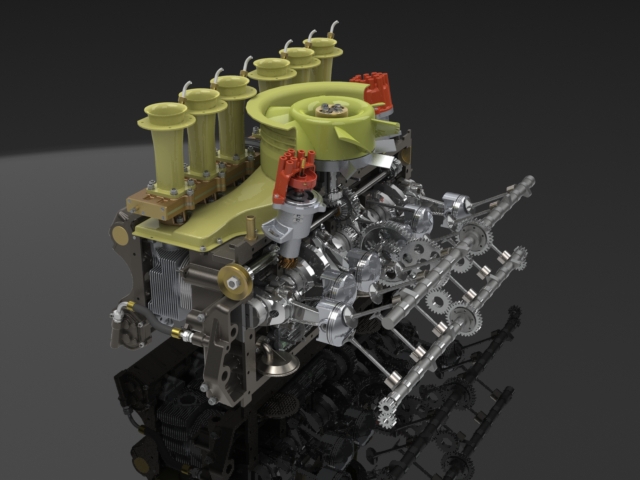

Here is the latest image of the 3-D model of the 917 engine. It's fairly complete at this point. I have decided to create an animation of the engine, showing the internal components in motion, that's why the engine is cut away. When it's done I will post it here. I am also going to render this image at 5120 X 4096 resolution. It should make a fair poster at that resolution.
