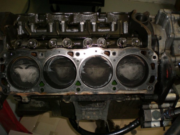

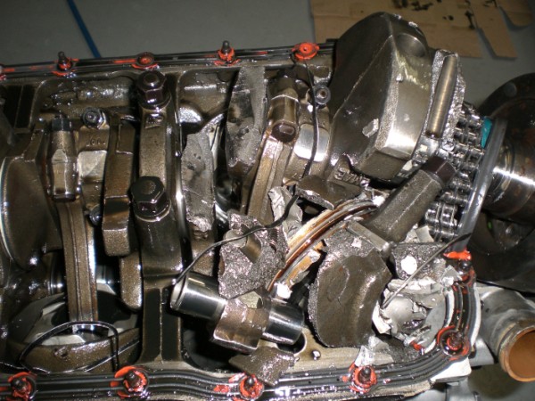

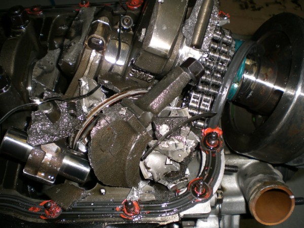

Back to the track Sunday morning and ready for the first race. We were held up on the dummy grid for a while while a big prang was cleaned up during the sports sedan race which preceeded ours. We were to have 2 warm up laps and as I started around the first lap it became apparent my throttle was jamming open and not allowing the motor to drop to it's normal idle speed. I figured this must have been the reason for the different run down sound on Saturday. I blipped the throttle relentlessly to see if the problem would go away but it didn't and we cam round to form up on the grid. I called over a flag marshall and told him I would pull out but it was too late and I chose to start and give it a go. I found The brakes would still pull the car up even though they were fighting the partially open throttle. I was holding my own and the car was handling superbly. I was into the race by about 4 laps when I started up the back straight. I can't remember exactly which gear I was in most likely 3rd when all of a sudden Bang! then nothing. I got the car off the track in case there was oil coming out of the car and coasted to a safe spot. I had a feeling I would not be running any more on that day and when the flatbed truck dropped me off oil was still emanating from under the car.

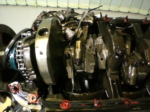

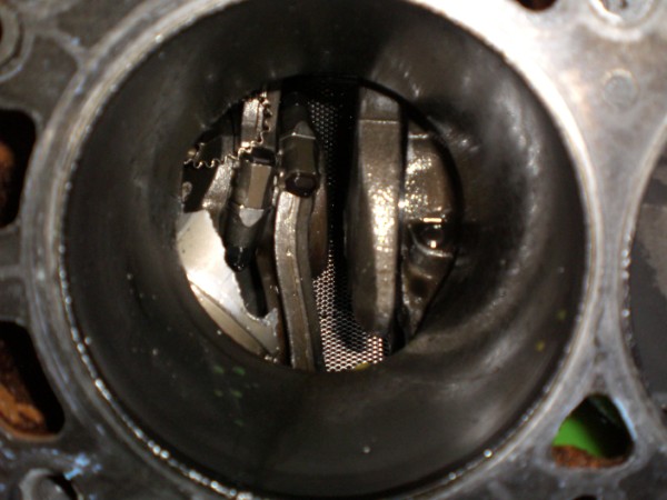

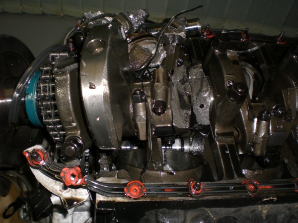

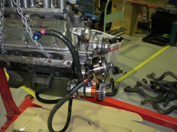

So my old nail of a motor that I have abused for a good few years now has gone (see the pics below) Now I am forced to get the race motor in to continue this season. I can't wait.By the way I packed up and came home early and mowed the lawns. The things you don't have time to do when preparing for a race meeting.

Russ Noble
Ross Mate, does it hurt? ;)

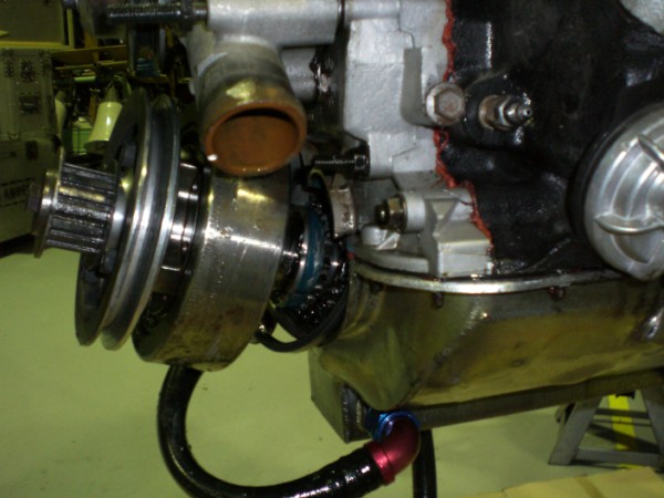

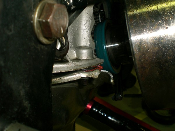

The front seal was never going to cope with that!!! Thank god it was your shitter motor and not the good one. Also that it didn't let go while you were over here, that would really have had us burning the midnight oil.
Sorry to hear of the misfortune, what are you going to do with that old motor?
Keep on smiling, when's the next race?
Ross -
Thanks for the report... I read along top to bottom, not cheating to read ahead or look at pics till finished..
If there's a ray of sunshine in any of this, it's that she didn't let go so badly as to oil down your tires. Then you may have had a very difficult time getting her slowed and finally stopped..

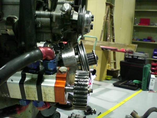

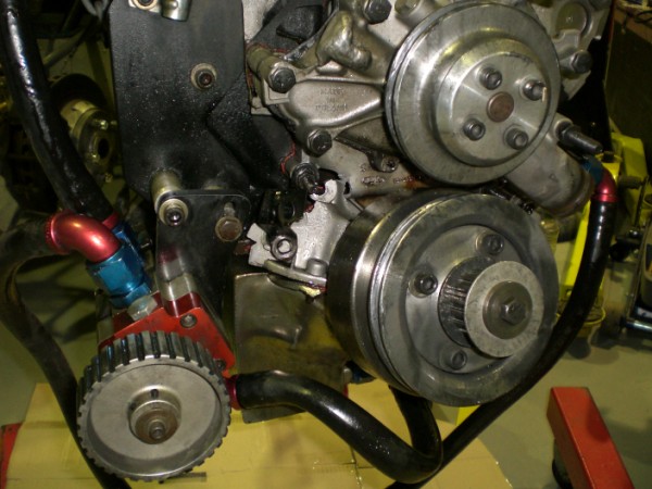

curious that it was the front of the crank.. Cast? Wondering about your tension on the oil pump drive. I'm kind of a nut about those things..
Looking forward to seeing the remainder of the autopsy on this poor baby...

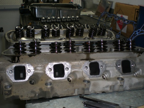

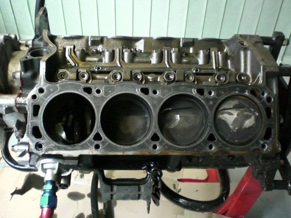

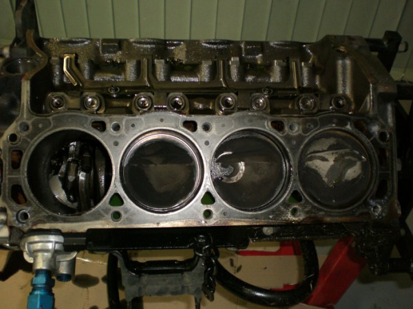

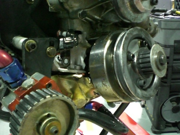

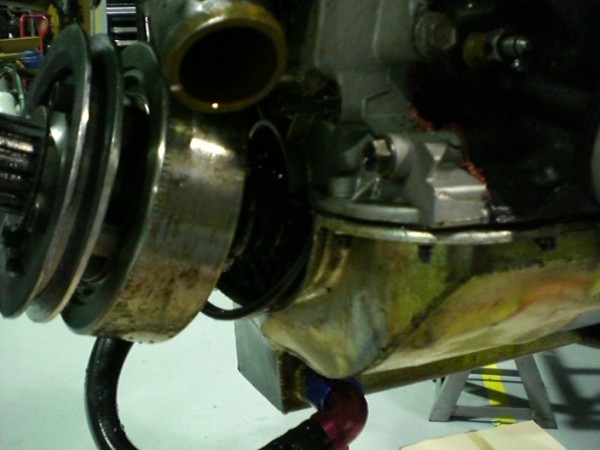

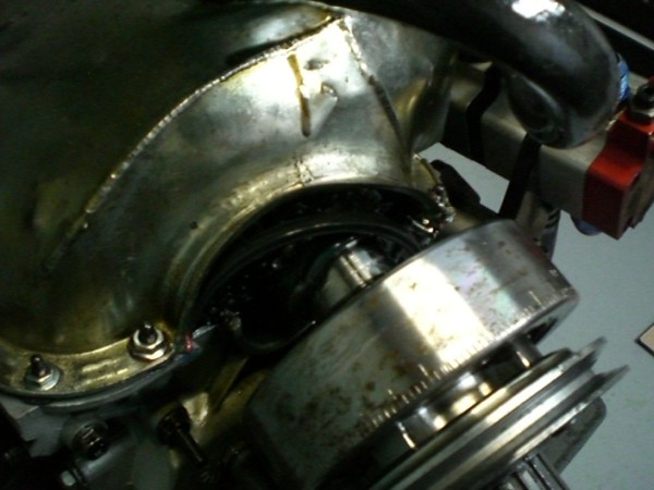

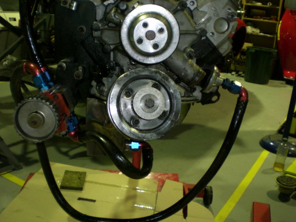

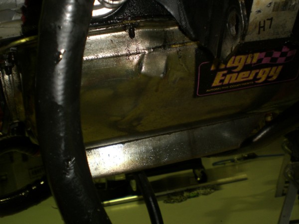

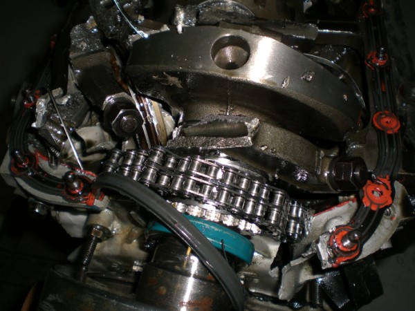

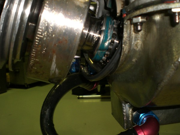

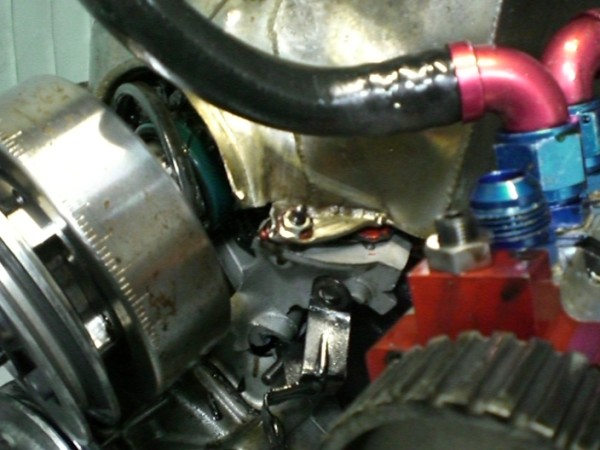

No Russ it doesn't really hurt! The fact that this could have happened during the NZ trip crossed my mind too. I'll salvage what I can out of this motor but it won't be rebuilt. The heads and the manifold are the only good bits left. The heads will need some new valves too. Yes Randy cast crank and rods. Very thin webbing around mains too. No the oil pump belt wasn't overtightened.
Andrew I suppose you won't be considering buying this motor any more. Pity, maybe the heads are of interest.

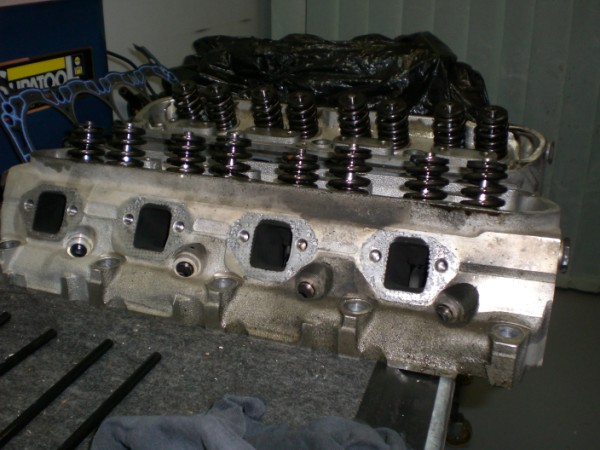

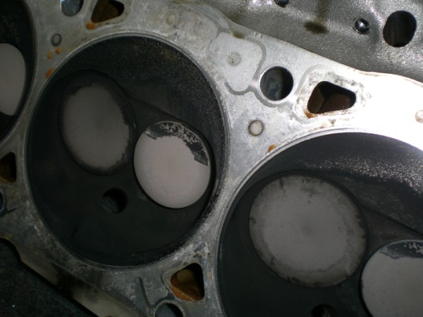

I took these further photos tonight after stripping the motor down
Ross

Neal
In the infamous words of David Hobbs... "BLAMO"
Sorry to see the carnage, at least you had fun doing it!
A mess to be sure...
I'm wondering if it might not be possible that one of the pistons started failing first (as you noted it was down on power) and then the crank gave up...
Still - luckily - it all looked pretty well contained...
Hey Ross. That's a bummer! You had a pretty strong field to contend with there! Good to see sports car racing is still going strong.
We will be down later in the year for Island Magic.
Look forward to catching up.
Its been running for a while with the crack @ front of #2 main ---- left side of photo 11 (90kb) post #6. Might see signs of oil starvation on #5 rod brg when you take it off journal, but it will be hard to tell what was before/after. Real cause might go back a couple of years to when you were having problems with injection/ignition IIRC .

It's amazing how much action happened in that short space in time. I'm not really doing any analisys of what happened when. I just think I got away with treating that motor badly for such a long time it doesn't matter.
