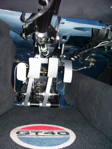

I got my pedal box from the machine shop today. They remachined the balance bar and pressed in the bearing I got from Aurora, and I was able to assemble it. I have asked Jay to pay the cost of this, plus I have again asked him to ship the parts that I need to finish the sway bar installation and complete the pedal box and get it in. (sway bar bushings and captive nut plates for the pedal box installation). I've also told him that I will dispute the last charge he made to my credit card (to which I've notified him he can no longer charge ANYTHING) unless I get a satisfactory resolution to all of this. We'll see how this turns out.
Jim Rosenthal
I think Gelscoe in the UK have the dead pedal; look on their site or look at them using Google.

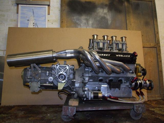

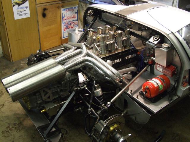

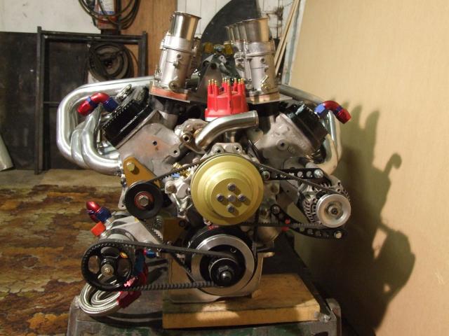

Finally installed - I am sure Martin will update you with the tale of this Engine, Frank

The engine finally got sorted out using Peter Knight of Knight Racing in Daventry. As you can see from the photos that Frank has posted, it looks great. I will post more photos once the installation back in the car is finished.
There was no more contact from Jay Cushman and it cost me £14,031 with Knight Racing to sort all the issues out including a full rebuild.
MWGT40
The engine puts out 545 BHP and 531 Ft Lb and is built on an aluminium block so it goes some too!
