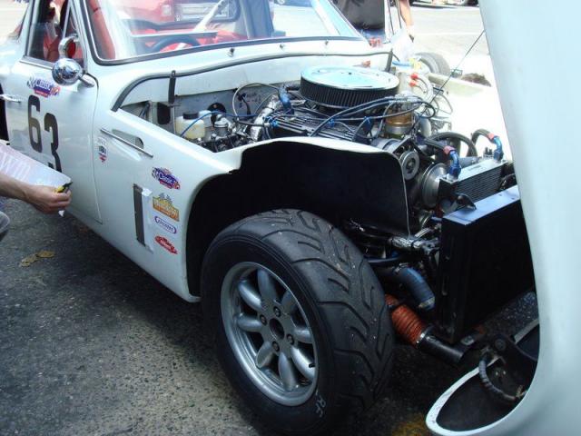

After Oulton, where the brakes were strong, I looked at the handling and using laser alignment, I'd dialed out the 3mm offset to the left that was present in the rear, so they now were square to the fronts. I also dropped the -3.75 degs of neg camber on the front right to -2.5 degs to match the front left and also reduced the front toe-out from 4mm to 2mm. Fresh plugs, Mintex 1155 pads + Sunoco 600+ fluids and 4 fresh Yokohama A048Rs completed the basic setup in addition to the normal servicing requirements.

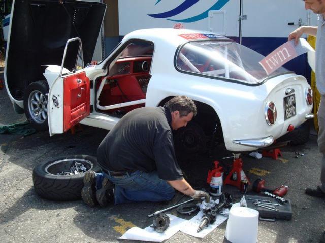

Post practice the car was set on stands to give it a check over and some slight rubbing of the rear LH inner tyre edge was detected and traced to the tyre wall touching the rear lower arm shock retaining nut. Uh-oh!, what was causing this??
Investigation then found the wheel bearing had developed some slack/play, with the outer bearing shell having slightly spun in the hub. So now it was a race to pull the drive shaft/hub assembly and strip/rebuild/repair before the now rapidly approaching race. As the event was local to Roy Smart - I'd invited him along and very handy that was too. The spacing / preload of the hub bearing assembly is controlled by a spacer/shim that I removed and gave to Roy, who promptly trotted off to an event resource for 'thinning'.
After a clean, some bearing retainer and re-grease, the hub was re-assembled and checked for function. Great - it was ok! 'Cinderella would go the ball'...
