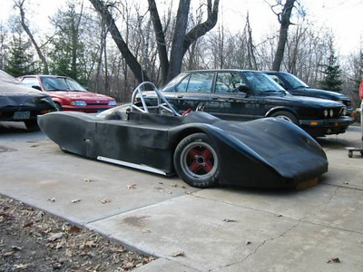

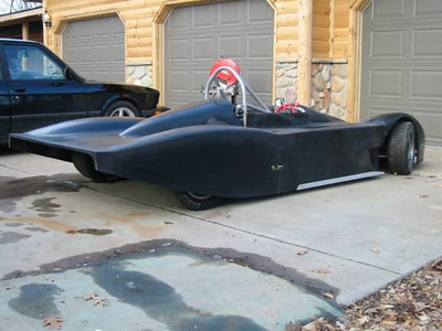

About the car,
weight with fluids, 750 pounds!
semi monocoque construction
front rocker type monoshock suspension
inboard suspension pic up points at near center of car
seqeuntial shift
just plain cool
It's a little SCCA sports racer with a Honda bike engine.
It's an older car with a flat bottom and no ground effects, so it's not a current nationally competitive car,,,,but it will be a blast for trackj days and regional events.
Currently output is right at 195-200hp and total weight with my butt in it will be around 940-950 pounds. First new purchase is going to be an onboard video/GPS system.
this winter, I'll be going on a diet myself,,,and saving for some lighter wheels, and maybe a carbon body for it.
Since I'm not planning on running SCCA national events with it,,,, I may even bump up the CCs from current 620 to about 1000. :)
My goal is eventually to be right at 900 pounds with driver at about 260-290hp. Then. I'll need to wear depends under my drivers suit.

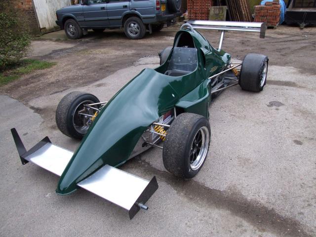

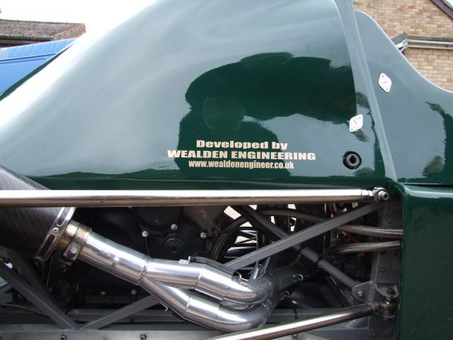

Alain, the way to go, lightweight bike engined cars have amazing performance for small money. Our cars are less that 700 lbs ( 300 kilos) with 200hp Suzuki GSXR1000 engines and are the class of the field in circuit sprints.

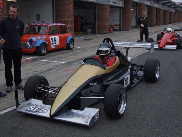

Hi Alain, I have a similar type car being built now, it did have a bike engine but it has now been replace. Car weight is now at 580kg but a lot more horsepower. The body is carbon fibre, built by Grant watson from Prosports.

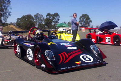

Hi Alain, There has been a new class for these cars in Australia with a 4000cc and above class. We have change the rear of the car to except a small block chev with a G50 gearbox. The G50 has a cnc cage built around it with the original prosport suspension, brakes etc.. being used. Grant has over engineered this car it will handle the extra weight and power. We originally went for a Subaru EJ20T engine but I picked up a dry sump aluminum Rodeck 372 engine with Kinsler injection converted to EFI. No worries about horsepower. In the street I live it has some unusual builds going on in the garages check out what the bloke next door is building.
