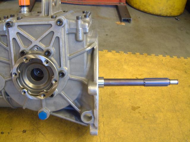

Hi Guys
The ZFQ/917 transaxle has the input shaft extended by 5" to allow the motor to be moved forward in the frame to help with weight distribution when running a flat 6 instead of the much longer flat 12 engine.
So if you want it to handle as well as it looks then you need a ZFQ/917 transaxle.
Regards
Chris.

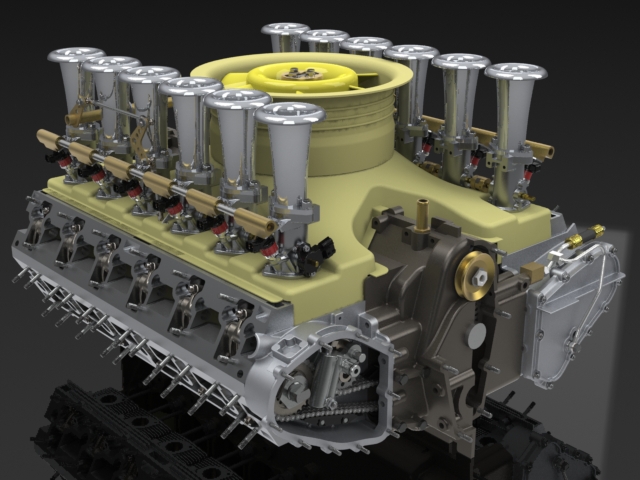

This is my idea of the ideal engine for the RCR917. It is based on Porsche 2.7L components, Heads, Cylinders, Connecting Rods. Most other components are custom. It could displace between 4.9 and 5.4L. 500 Hp should be no problem. I'm about 75% done with the design. Hopefully someday I will be in a position to build it.

great Stuff mark !!!!:thumbsup:
That's THE 917 engine for replicas....

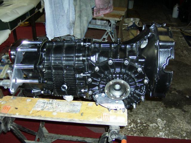

From my personal experiences of circuit racing i have had no problems at all with my 915 mated to a 3.6 ltr 964 engine. 802 kgs and driving 15" rims and Dunlop CR82s, building carefully and being mechanically sypathetic makes a big difference to reliability and long life.The very stresses of motorsport do inevitably take a toll on most parts, and i,m sure that one day something will give way, but so far all is good and that is since August 2005. Picture shows my current 915 box whilst out of car during engine top end rebuild last year.
Pay your money and take your choice .............. Porsche parts cost heavily.
Graham.
