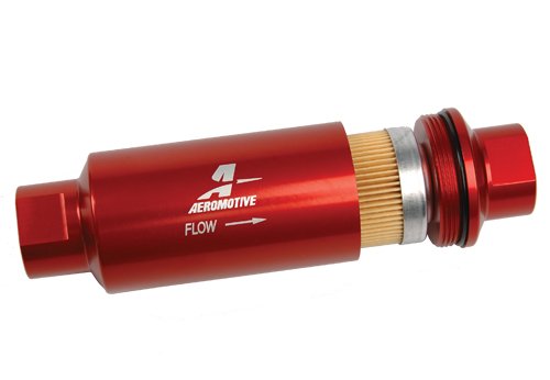

the 100 micron prefilter has a washable stainless stell filter element
the 10 micron has a replacable filter element
check the aeromotive site for flowrates and pressure drop. Pretty good stuff

Btw, can anybody explain why my pre-pump 40micron filter has a circumfrance of 2.5ish, whereas my post-pump 10micron filter is 6.3 in circumfrance? I figured that the larger circumfrance would belong to the filter with the higher filtration, not the lower filtration?
Nevermind; found it; areomotive fuel clamp. Damn, that's expensive - 70 for a clamp!
It is, the finer filter (10 micron ) needs more filter area to flow the same amount of fuel without causing a greater pressure drop.
